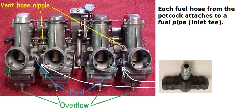

03 Mar 2017 18:10 - 03 Mar 2017 18:11When carbs with "dry" fuel pipes are returned to service, the fuel pipes may leak slightly from their supposedly snug fit into the carbs. Sometimes, exposure to fuel for a few hours results in a slight swelling of the raised ridges on the fuel pipes enough to eliminate the leakage.

This is a common problem of the inlet tee.
They dry out and get hard if no fuel is in the fuel hose.
10 years ago i installed new ones in my carbs and after the years they begin leaking like yours.
I solved this leaking problem in my rebuild project with a shrink tube over the rubber part that plugged in the carb body.
Michael

I believe the inlet T was to blame. I got the bike on Saturday and he said the fuel leak was resolved. I woke up Sunday to a large puddle. The mechanic replaced fuel lines and I made sure they were tight. No more leak on Monday. We will see if the issue is truly resolved.
