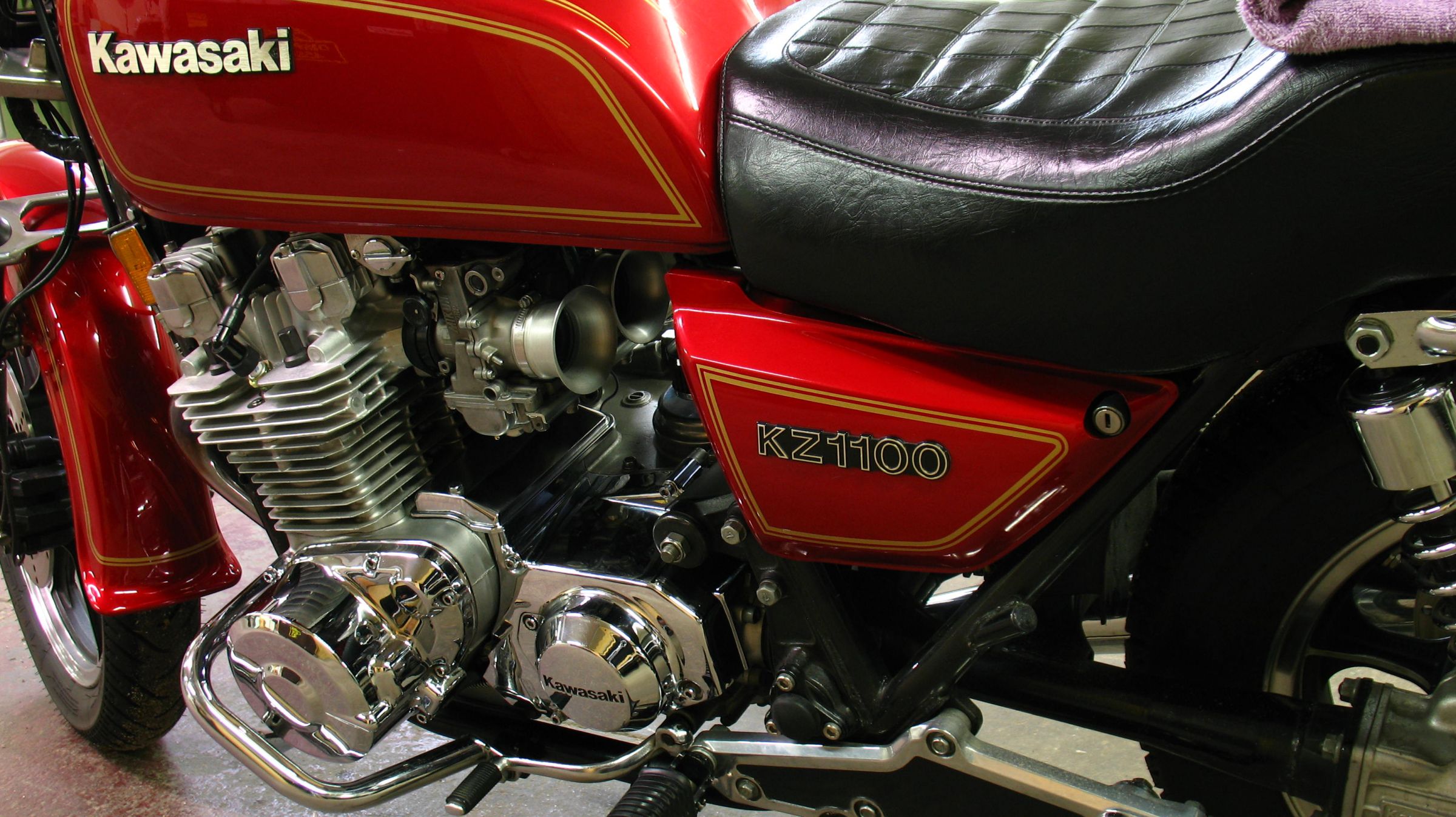

After Stabil-izing the fuel in the gas tank, I usually take an hour ride before parking the bike in the corner of my shop, where the air temperature stays between 50-65 degrees through Winter.

Had to try with the stacks that came with the 34's for a cool-brisk ride last night. Its getting cold out, but no snow yet.
I adjusted the floats to 17.75mm+/- and straightened up the drain tubes inside the bowls. The tubes may have come from Mikuni set at different angles, but now they are the same and all reach higher inside the float chambers, which should help prevent fuel from getting in them.
