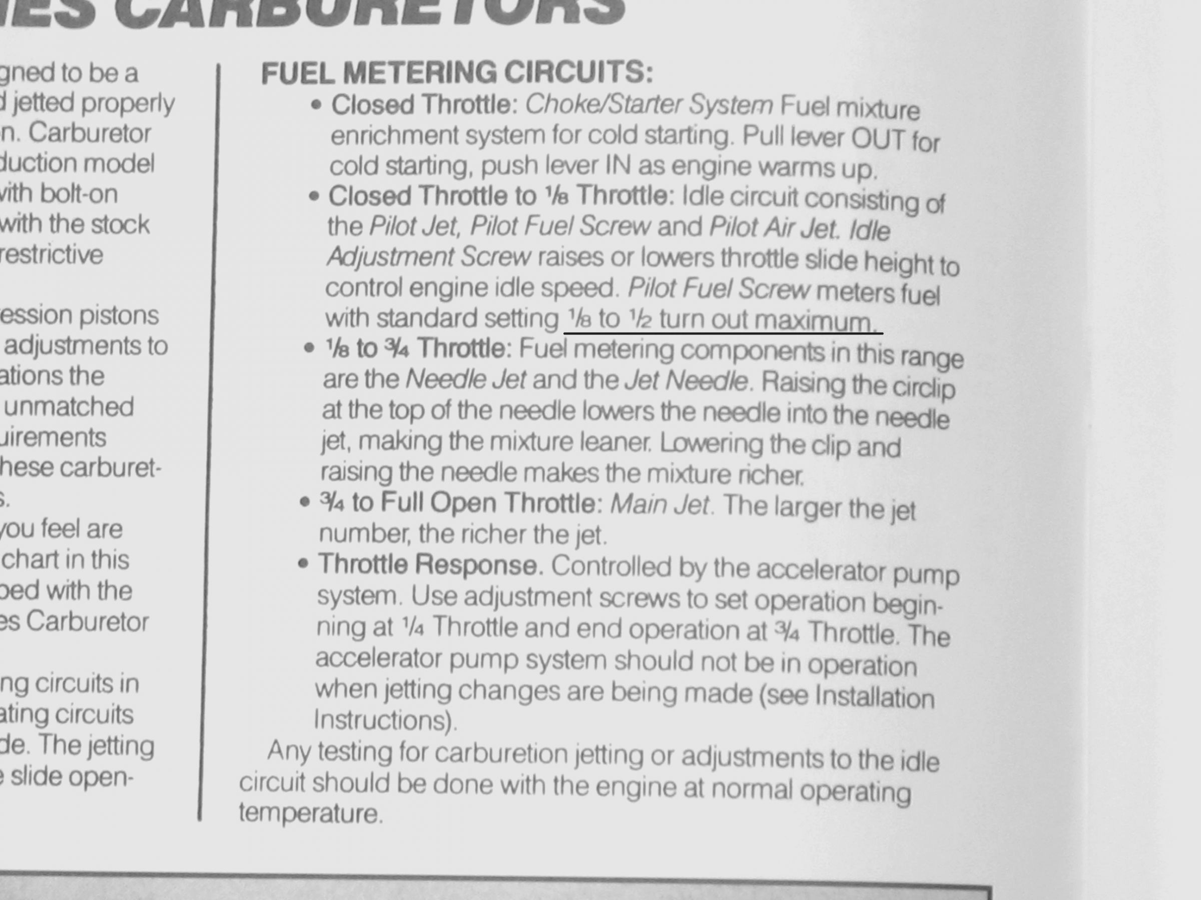

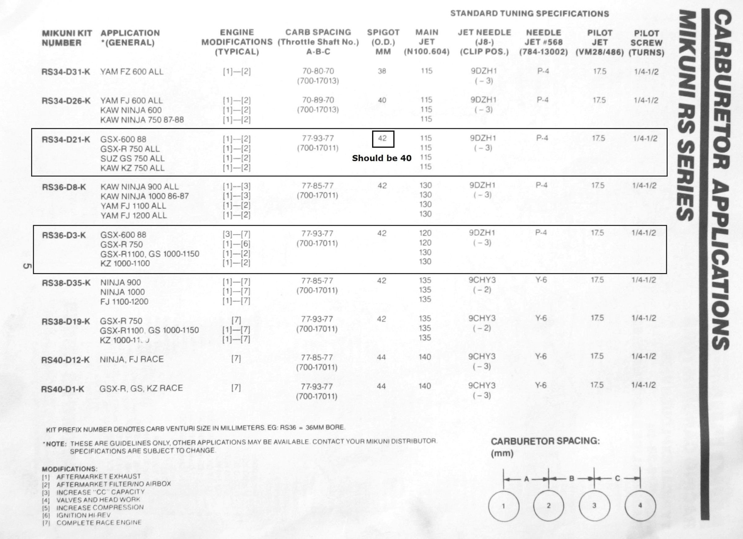

Application chart from the Mikuni Owner's Manual below. Note emphasis:
Tuning information from same. Note Pilot Fuel Screw adjustment range:
