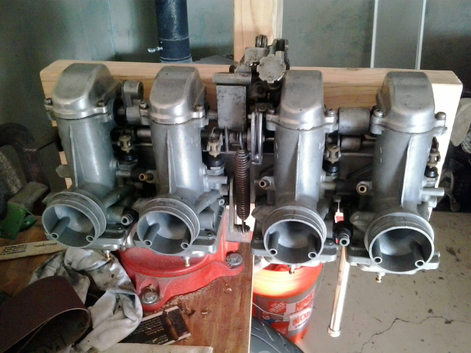

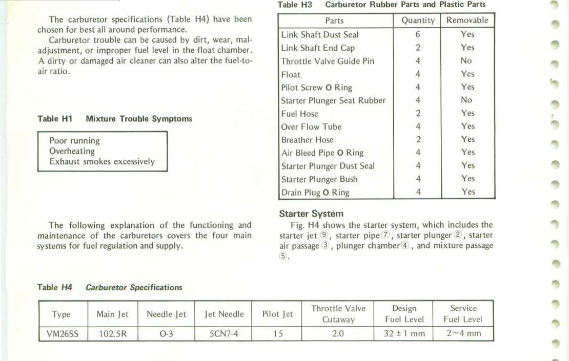

Awesome info Patton. Based on your data it seems these carbs are from a 1977 model. I didn't pull a needle to get the numbers because I was feeling lazy.
I need to make a tool of some sort to check the fuel level but I set all the floats to 24mm and didn't get any overflow.
The stink'n fuel tees are leaking though so it looks like this set is going to come apart again. I soaked the Tee's in gasoline for a couple of hours before install to swell them a little but wondering if some more time may be in order? I'm thinking about putting the carbs outside with fuel in them for the day to see if some more time may swell the tee some more.
Might be best to just bite the bullet and just get new Tee's. Fuel leaks suck.

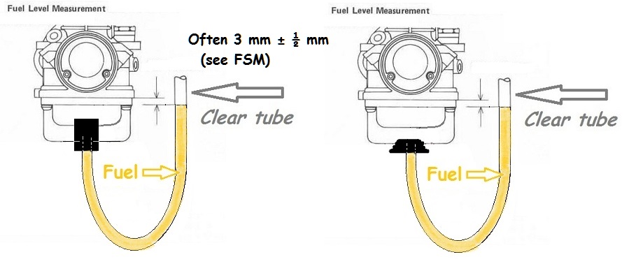

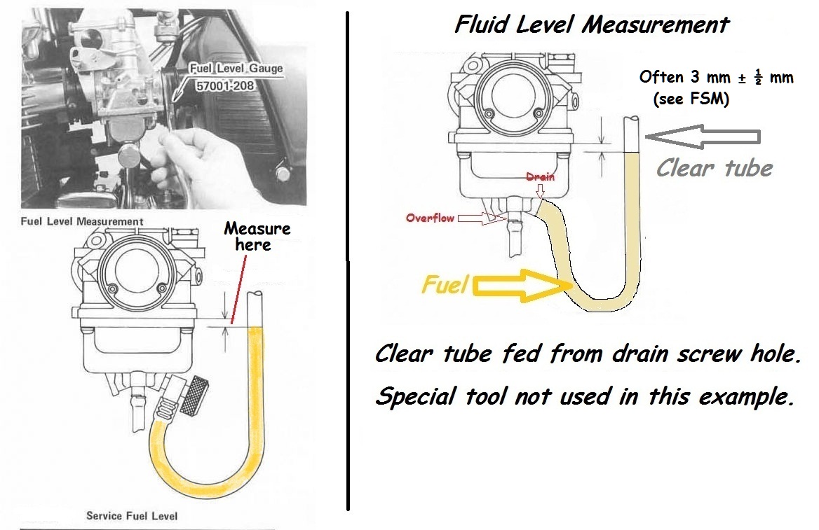

I've been using the clear tube test method to set the service fuel level without worrying about the measured float height, reasoning that whatever float height produces the correct fuel level is the "correct" float height for the carb at hand.
I prefer doing the clear tube testing and float height adjusting using common household rubbing alcohol instead of gasoline, in the garage atop the work bench or better yet inside on the kitchen table, where alcohol avoids stinking up the place with the odor of gasoline.
After installing the carbs, can verify the correct fuel level with clear tube testing, which for me has stayed within spec.
I don't fool with the "special" tool, and simply use a clear tube having an outside diameter that self-screws into the drain plug hole, which works quickly and easily, and without leakage.
On the 29's, a conical grommet pressed into the drain hole holds one end of the clear tube, again without fooling with a special tool.

No secrets. Glass bead blasting and replating all the zinc parts.
I'm familiar with performing the clear tube test. Just didn't have the proper size tubing.
Set the carbs outside with fuel feeding the Tee's. Hoping the gasoline will swell up the Tee enough to stop the leak. If they are not leak free tonight when I get home from work I'll order new Tee's. Rubber coated types are about $22 each (need two) or aluminum ones are $17. The aluminum is not anodized though which is not ideal. I think there are brass tee's out in the market too. Do the KZ purest types prefer the stock type or does it not matter?

Came home from work yesterday after the carbs sat with fuel feeding the Tee's all day and now there is no more weepage. I think the Tee rubber has swollen up enough to stop the leak. On my 750 the fuel warning light sensor leaked like crazy after sitting dry for some time but likewise, after a good fuel soaking the leakage went away completely. Fingers crossed. I've got fuel feeding the Tee's again today and I'll wiggle them around good and vigorously when I get home tonight to see if I can induce leakage. if not, I'll call it done and leave the Tee's alone.

The carbs on my 78 a2a has a vacuum nipple on the #3 carb and due to energy crisis they stepped the jets down to 102.5 on the mains and 15 on the pilot jets.
With Jardine pipes and with the stock jets I was getting close to 50 mpg but the engine was running hot with the leaned out carbs.
Wire George recommended going with 107.5 and 17.5.
Now the bike runs a lot cooler and has a bit more pickup, the trade off is gas consumption,is somewhere around 45 mpg now.
78 a2a carbs and data

Your carbs look real sharp, you may want to coat them with something before they start to oxidize
78 KZ1000 A2A
- Posts: 7899
- Thanks: 3275
Re: VM26 Specs Needed
16 Nov 2016 15:25bluej58 wrote: Your carbs look real sharp, you may want to coat them with something before they start to oxidize
That's not a bad idea. I've got some Wizzard's Power Seal that's supposed to work well on raw metal. These carbs are not going to stick with me though. I redid them to resell.
