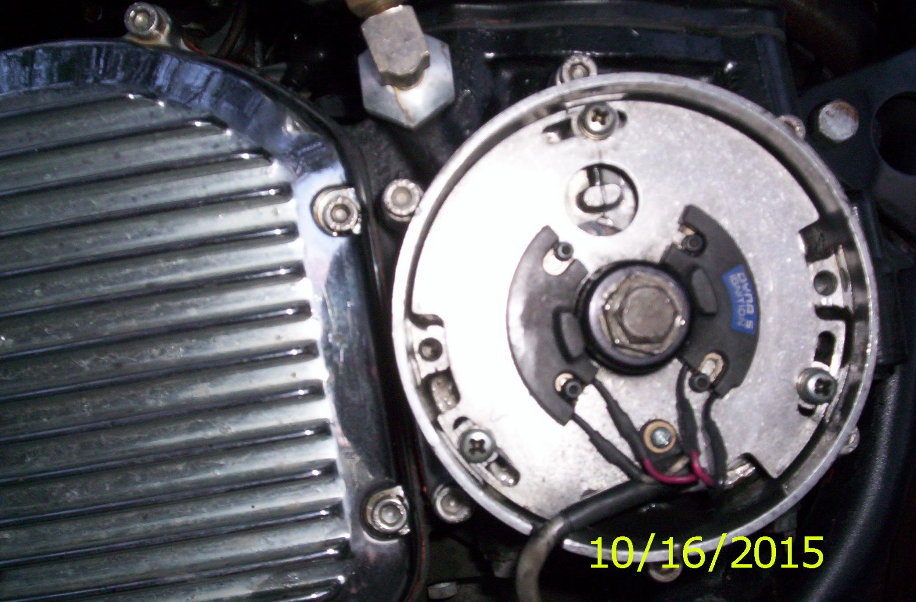

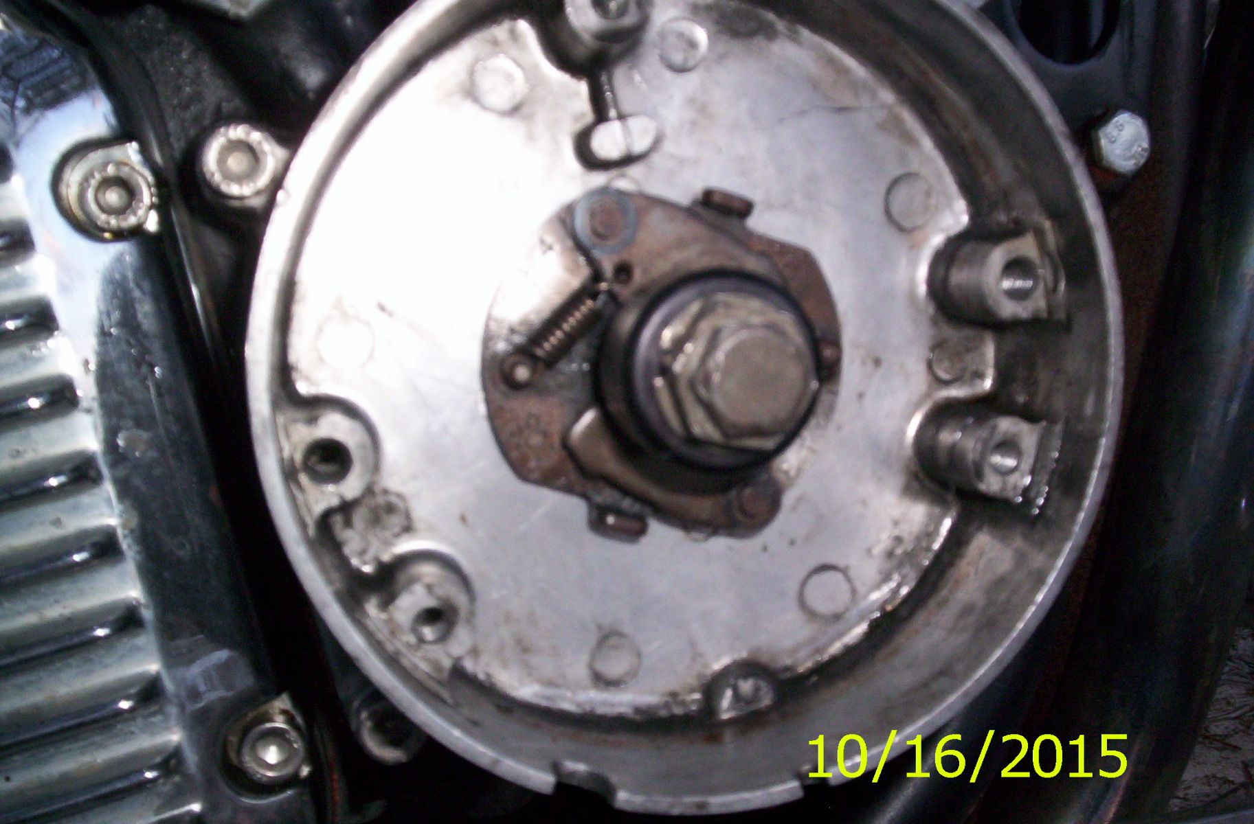

- OLJOCLARK
- Posts: 55
Re: Jet size question
11 Oct 2016 10:09
Here's a pretty clear picture of the spark advance,A lot of wear on the one side and the springs are a little loose.I dont really understand what this does for it.Does it look like it could cause trouble? I'm gonna try to find a picture of a good one.
1980 Kawasaki 750 ltd G Twin
