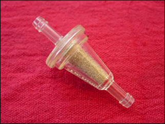

inline filter -- If it isn't a fresh filter of the following style, would consider replacing it.

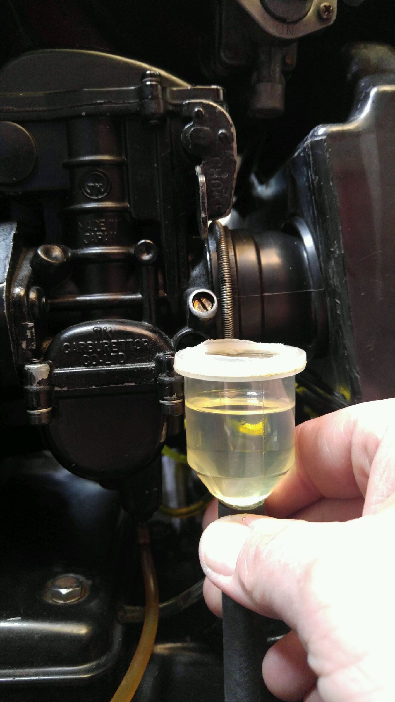

Does your bike have Keihin carbs with the rubber tipped float needles? If so, they are persnickety and love to overflow. For one thing there can not be any debris entering the carbs as mentioned by Patton. I'm not sold on those gold-stone filters though since they are not the greatest quality and the stone is more a strainer then a filter. Better than nothing though. You really need to spend the time and do the clear tube test to be sure your float heights are all properly set. On most of the Keihin's I've rebuilt the fuel level was set too high and I had to bend the float tang a fair bit before the carbs would seal reliability. To measure is to know.

Clear tube test as already noted would be a great idea. I used an old clear fuel filter and cut the housing open and removed the filter, used ot as my "clear tube".
