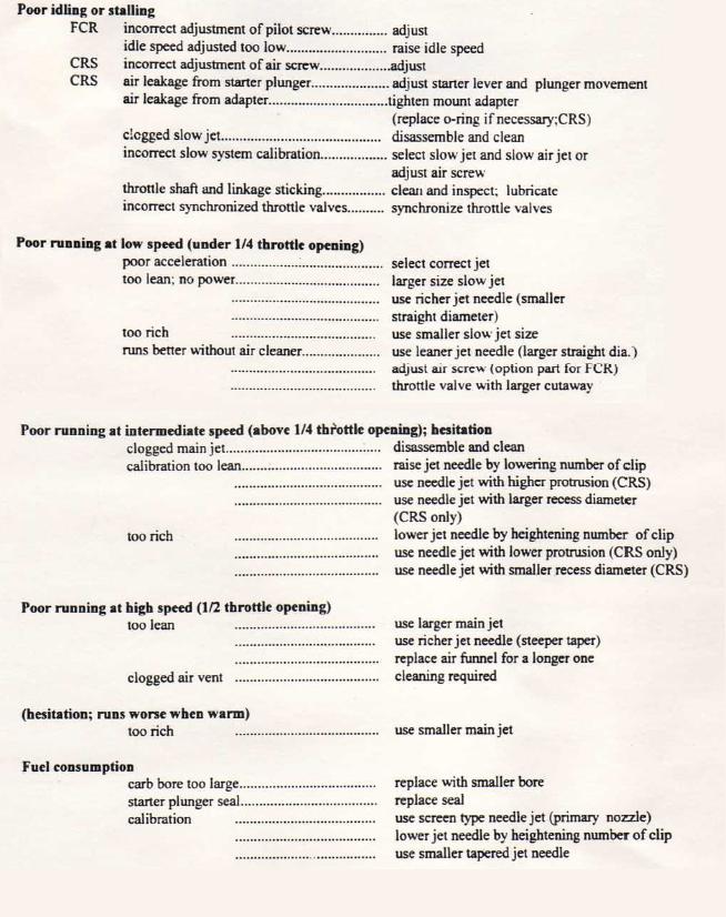

Cr's are a little finicky but once you dial them in... response is awesome, All worth the learning curve on these beauties.
Questions...
Elevation where you live/ride....?
Ambient outside temps, humidity etc...?
You running Pods or stock air box...?
Ignition timing set correctly (timing light)...?
Valve clearances to spec...?
Possibly these will help you diagnose your mid to high rpm issue....
OMR
Questions...
OMR

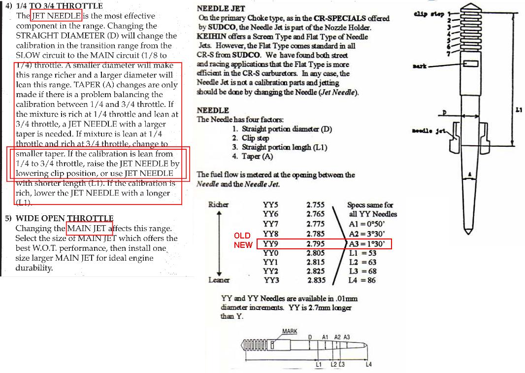

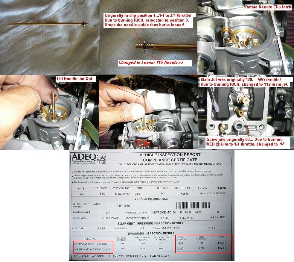

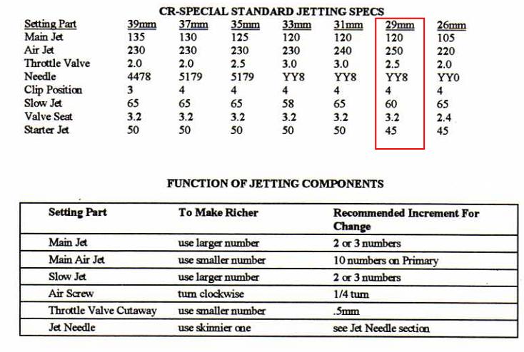

Re: Need help with Jets im kinda lost lol
19 Jun 2016 07:12 - 19 Jun 2016 07:13
Phoenix AZ elevation ~ 1200 feet
Heat index average other than 3 summer months (100-115F) changes where 70-90F
NOTE: CR's shipped are extremely RICH from factory....
Main Jet @ 112
Slow Jet @ 52
YY9 needle
Main Jet @ 112
Slow Jet @ 52
YY9 needle
