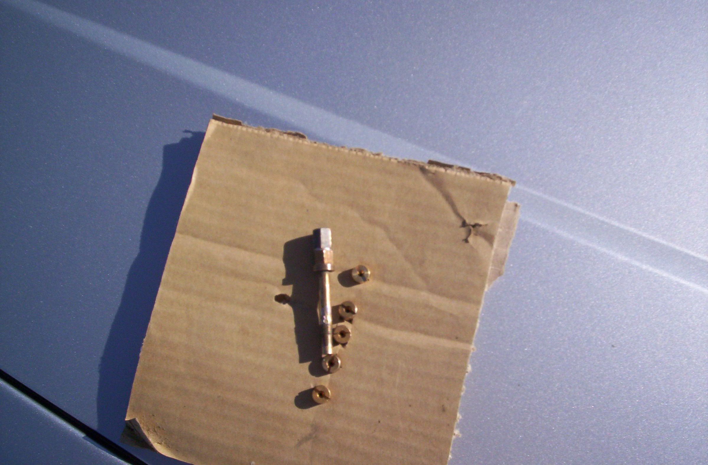

Had to sleep on it. I'd like to see pics of the one carb opening. The 33 and 29's are similar internally. Some parts are interchangeable. #3 on my 33's has a fuel port at the bottom of the bowl. The linkage has linkage that can be used for an accelerator pump. I suspect yours has an option of some kind and that's why it is acting differently. As you said, they do come out. Looking at the jetsRus needle jets, I don't see mine.
Can you take a pic of yours to compare?
You can get the air jets if the ones you have are munged up.
Syeve
Syeve

04 Jun 2016 07:15 - 04 Jun 2016 07:24swest wrote: Had to sleep on it. I'd like to see pics of the one carb opening. The 33 and 29's are similar internally. Some parts are interchangeable. #3 on my 33's has a fuel port at the bottom of the bowl. The linkage has linkage that can be used for an accelerator pump. I suspect yours has an option of some kind and that's why it is acting differently. As you said, they do come out. Looking at the jetsRus needle jets, I don't see mine.
Syeve
Mine are like the needle jet and main jets shown in your first picture. The needle jet threads into the carb (into the jet block, actually). Then the main jet into the needle jet. The air jet is like the one pictured last and comes right in and out no problem. The problem is not at the air inlet side (by the air filter) but at the other end, where the passage opens up into the main jet passage (where the needle jet and jet needle are)
