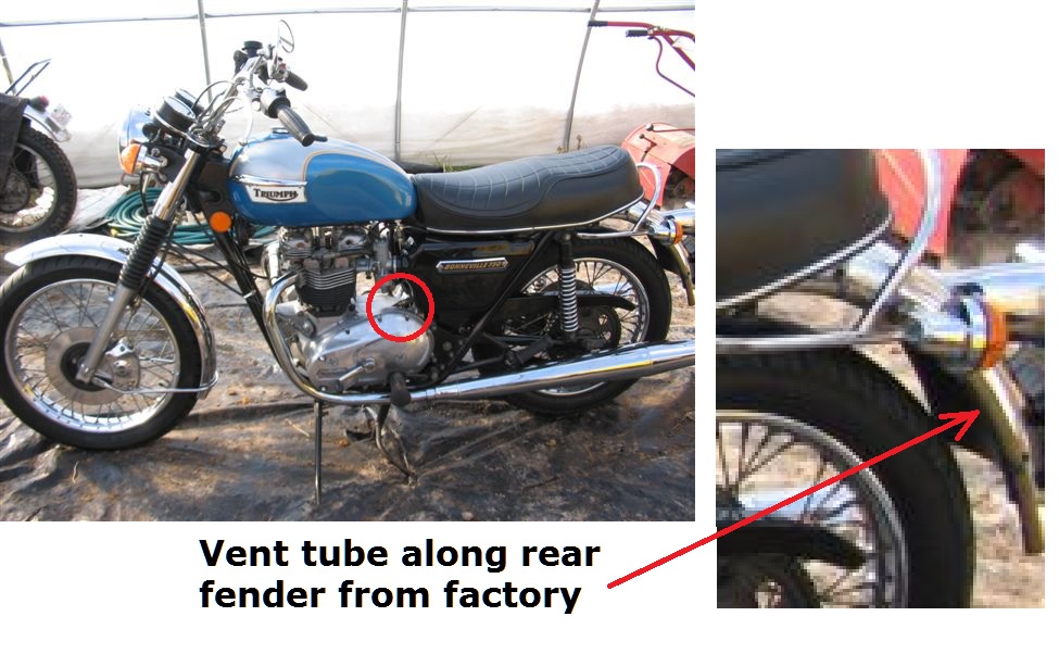

Am uncertain about current models of Triumph and BSA, but earlier year models for several years came from the factory with engine crankcase oil vent tubes routed from the engine along the rear fender to exit behind the bike.
(I don't recall how Norton may have addressed this aspect.)
