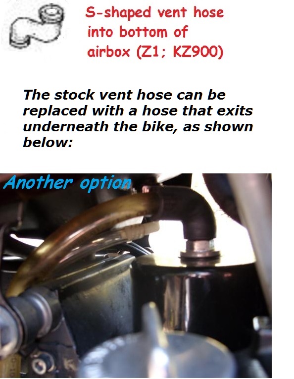

Since you are running pods...what did you do with the crank case breather line?

No crankcase breather line. Just open to the atmosphere from the crankcase breather body or cap.

19 May 2016 22:42For racing applications, a "catch-can" may be used toward helping keep oil off the track.

Nice Picture Patton and was thinking about using a vent tube routed somewhere else. Still trying to determine where this oil I'm seeing is coming from ? As the bike is idling, I can feel a little pressure out of the top of the breather cover but not seeing any oil spraying from it.

I'd run a hose up along the frame then down to the chain. The extra run will help condense the oil vapor and lube the chain at the same time.
