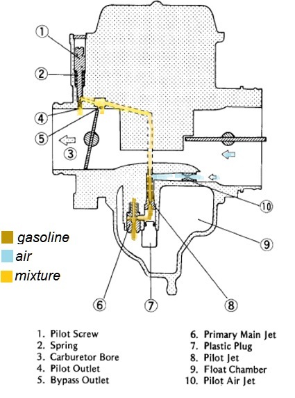

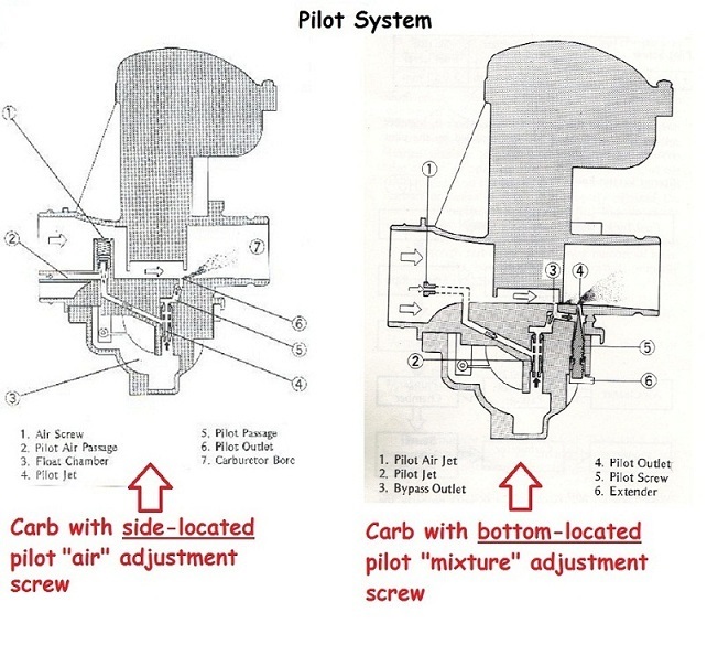

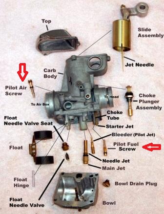

When a pilot screw is located on the "engine side" of a carb, it's usually a "mixture screw" as opposed to an "air screw" which "air screw" is usually located on the "air-box side" aka "air-intake side" of the carb.
A pilot "mixture screw" turns IN to lean (providing less air/fuel mixture) and OUT to enrichen (providing more air/fuel mixture).
A pilot "air screw" turns OUT to lean (providing more air in the air/fuel mixture) and IN to enrichen (providing less air in the air/fuel mixture).
Most CV carbs have a pilot mixture screw
VM manual slide carbs may have either pilot air or pilot mixture screw
And to keep things simple :ohmy: , there's of course at least one known odd-ball carb that has both a pilot air screw and a pilot mixture screw. :lol:
