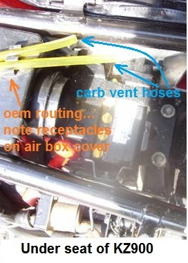

All 4 float bowls are vented through the two vent nipples. Usually there are two hoses (one hose to each vent nipple), both of which hoses exit to open air.
Absent the hoses, with the nipples exposed :ohmy: , it's easier for water or other foreign matter to enter the carb through the open exposed nipples, or to just clog the nipple openings (which disables the venting requirement).
My KZX900 vent hoses are run in the stock routing positions to exit underneath the seat.
The vent hoses could just as well be routed to underneath the bike and exit to open air.
Length of the vent hoses doesn't really matter, provided they aren't kinked or obstructed.

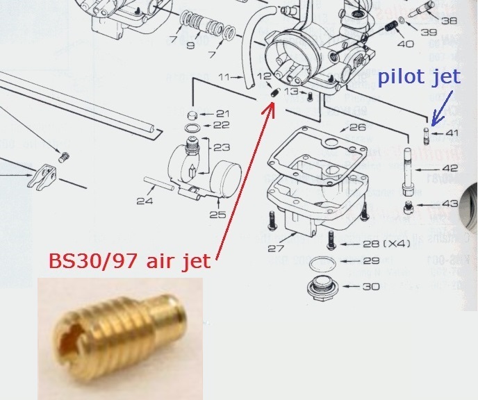

As shown in the Sudco Tuning Manual 4th Edition, the VM33 smoothbore carb main jet's access to air intake is metered by a BS30/97 air jet, which should be clear, clean and open, undamaged, unclogged and unblocked. If in doubt about 100% serviceability of the air jet, replacements are inexpensive and readily available. Efforts to clean/clear the jet by reaming it out will likely prove less than satisfactory, as I believe the orifice is designed for precise metering of incoming air flow into the main jet.
www.z1enterprises.com/product/SU002-154
I don't know why the Z1E listing mentions applicability only with reference to 29mm smoothies, and fails to mention its applicability to 33 mm smoothies.
The Sudco manual shows BS30-97 air jets on both the diagrams and parts listings for VM29 and for VM33 .
EDITING MEMO -- See following posts which indicate that the BS30-97 Air Jet is for metering incoming air intake provided to the main jet -- not to the pilot jet.

Patton, that's for the main circuit. The pilot is on the right.

16 May 2016 08:22 - 16 May 2016 08:38swest wrote: . . . that's for the main circuit. . . .
Thanks, Steve!
As I understand what you're saying is that the BS30/97 Air Jet meters air intake for the main jet and not for the "pilot" jet.
My post #726741 has been edited accordingly.
MAIN JET (air intake governed by BS30/97)
PILOT JET (air intake NOT governed by a BS30/97)

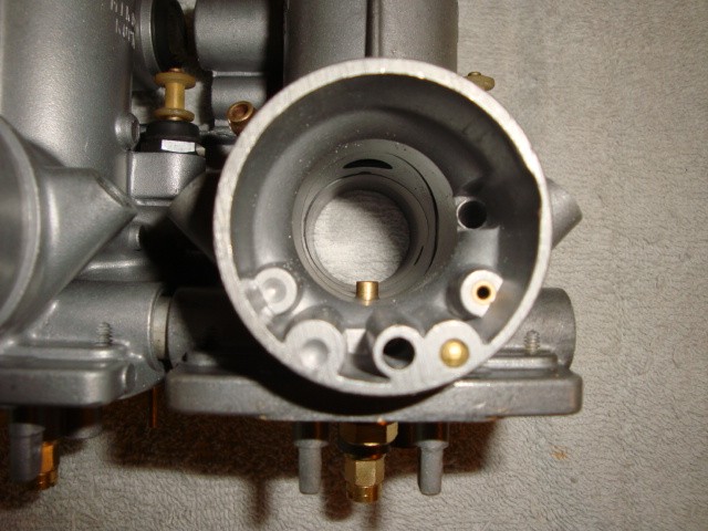

It's been a while since I've sprayed carb cleaner into the small holes entering at the air box side of the 29 smoothies to see where it comes out.
It must be a different hole -- not the BS30/97 hole -- that goes to and furnishes incoming air to the pilot jet.

Richard is talking about the vent line, item #11 in the factory drawing. There is a vent for each bank of two carbs to allow atmospheric pressure be in the bowl so that fuel can be drawn up and into the jets. If this vent line did not exist, fuel would only pull until there was a vacuum in the bowl. As an example, have you ever drawn through a straw in a juice box and found it started to collapse, same idea.
