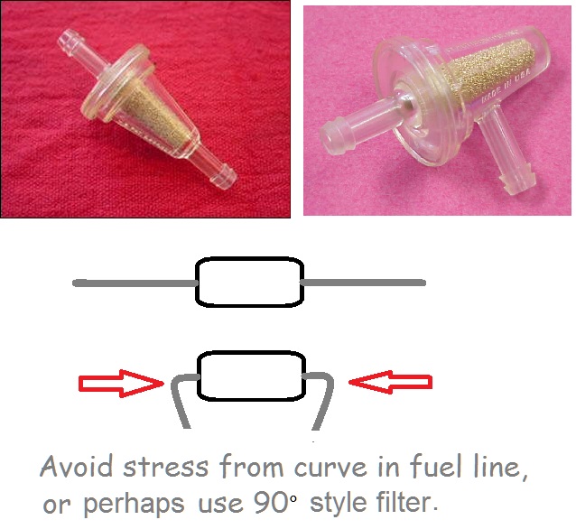

30 Apr 2016 02:26Note the metallic filter element.
As carb-fitted motorcycles are gravity fed (gasoline flow from the fuel tank is dependent on the force of gravity alone -- not a fuel-pump), Inline filters with a paper element are likely to allow insufficient fuel flow through the filter and result in fuel starvation.
