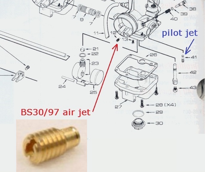

Hey Patton where is that air jet, im a little backwards when i read schematics. Is that in the front of the carb body? screws into one of the many openings in the lower lip so to speak?

The air jet is on the intake/air-box side of the carbs.
It's easy to mess up when attempting to extract the air jet.
Would first soak it overnight witha penetrant such as PBBlaster, Kroil, 50-50 mixture of ATF/acetone, Liquid Wrench, etc.
And use a screwdriver of the perfect size.
DON'T FORCE IT!
