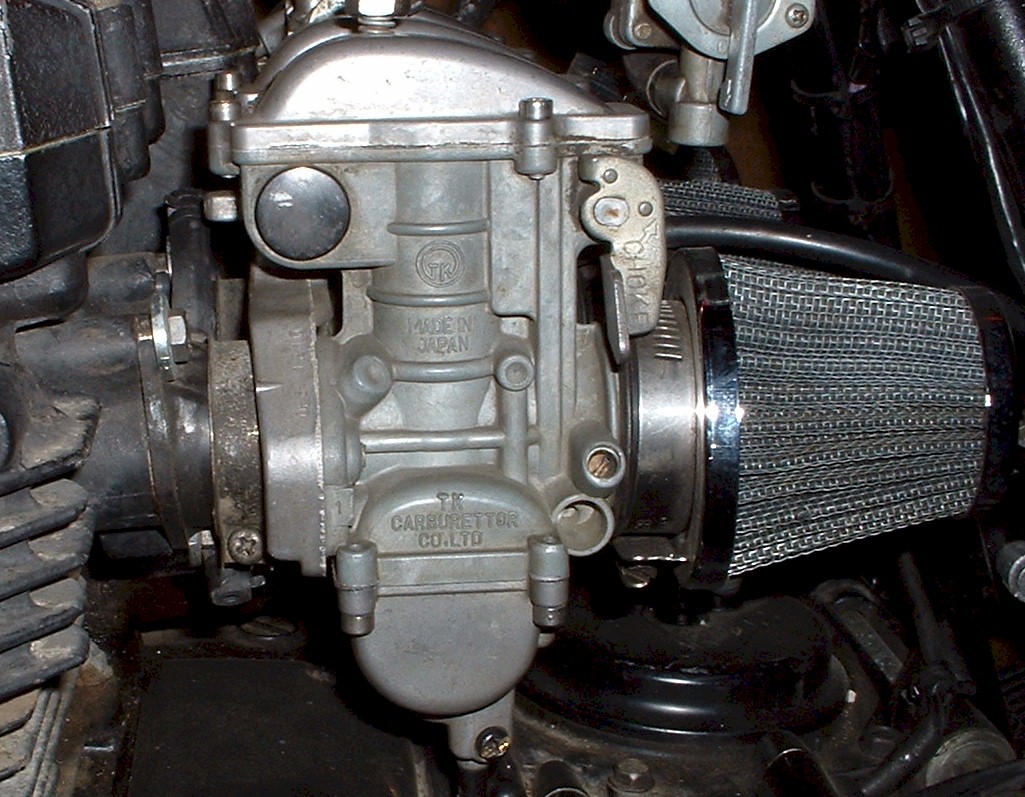

Yes, it's a very tight fit. But the rubber stretches over time and takes a "set". Notice the two left pair, and the two right pair are the ones that interfere. Put them on together in pairs so they will equally push on each other. Just snug the clamp enough so they don't pull off easy, and the filters will stay just fine. If you go too tight, you can cut the rubber.
In some extreme cases I may have squished them a tiny bit in a vise. But be careful. If you over-do it, you can break cement.
The choke lever is very ductile. You just bend the lever out a tiny bit and it will clear with no problem. Actually, on the gpz, often times the lever hits the corner of the airbox as well, so whether you have pods or airbox, you probably want to bend the lever outward about 10 degrees.
Here you can maybe see it. It's bent right across the letter "C" in "CHOKE".
