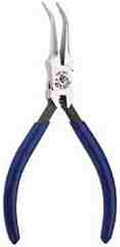

Perhaps hold the tee in position with needle nose pliers while attaching the hose.
I regularly enjoy using long version needle nose pliers for many purposes, including fuel lines, but am usually grasping the hose end instead of the tee joint.
The short version might also serve the purpose.
I see that Harbor Freight carries some inexpensive examples:
www.harborfreight.com/hand-tools/pliers/...ight-jaws-39540.html
www.harborfreight.com/16-inch-long-reach-pliers-set-38598.html
