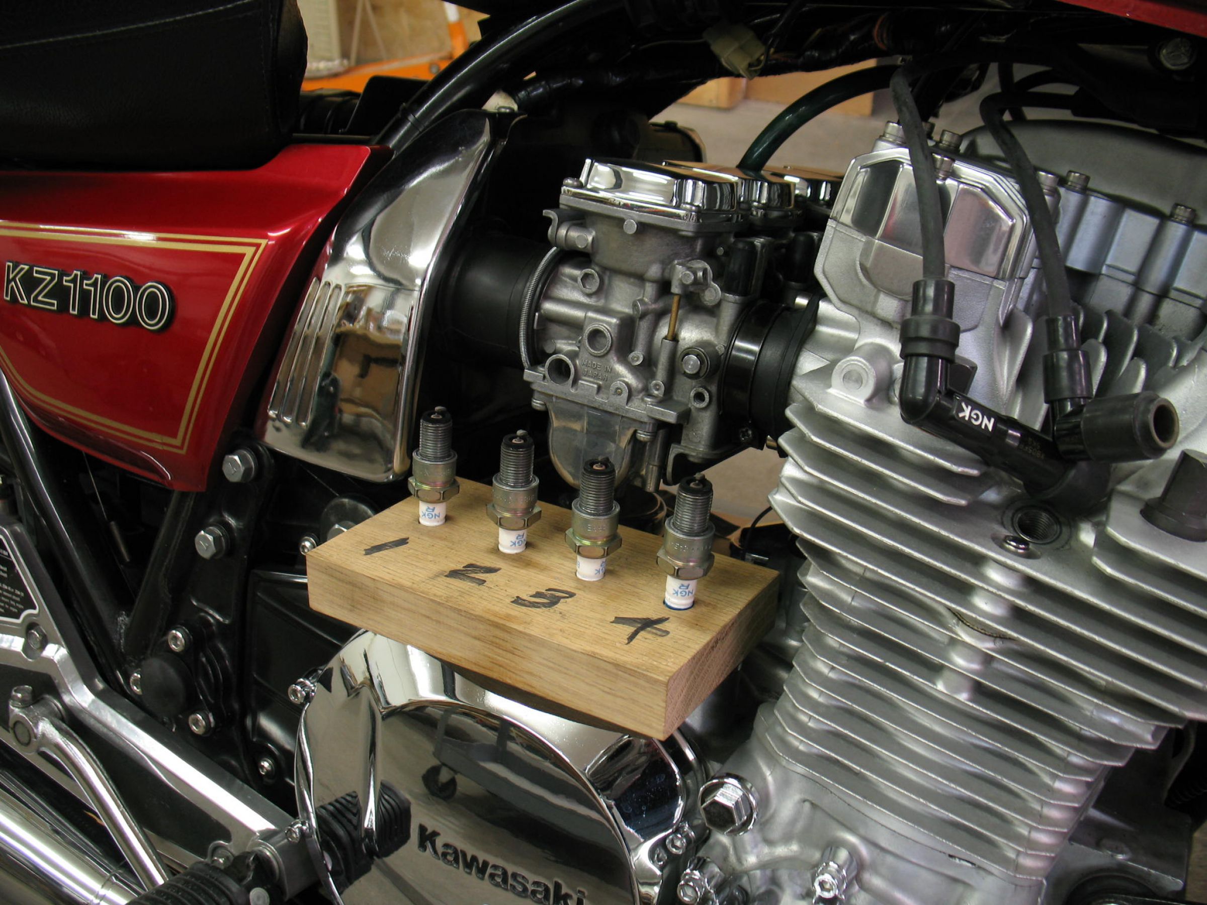

31 Mar 2016 21:56 - 31 Mar 2016 22:01swest wrote: That's pretty damn close. Maybe it's the fuel. Sometimes mine has a purple hue. :whistle:
BS34's with the V&H Competition baffle. Few if any pops on decel. :kiss:

Are those resister caps and resistor plugs. If so I would go with standard plugs.

01 Apr 2016 09:08 - 01 Apr 2016 09:09swest wrote: Are those resister caps and resistor plugs. If so I would go with standard plugs.
Good ? Steve
The plugs are resister platinum/iridium NGK BR8EVX, and the black NGK caps are non-resistor. So there is only the resistance in the spark plug as set up currently.
I was running non-res U-Groove 142 Accel plugs with red res caps for awhile, before switching over.
1982 KZ1100-A2

That's good now RIDE THE PISS OUT OF IT. :woohoo:
