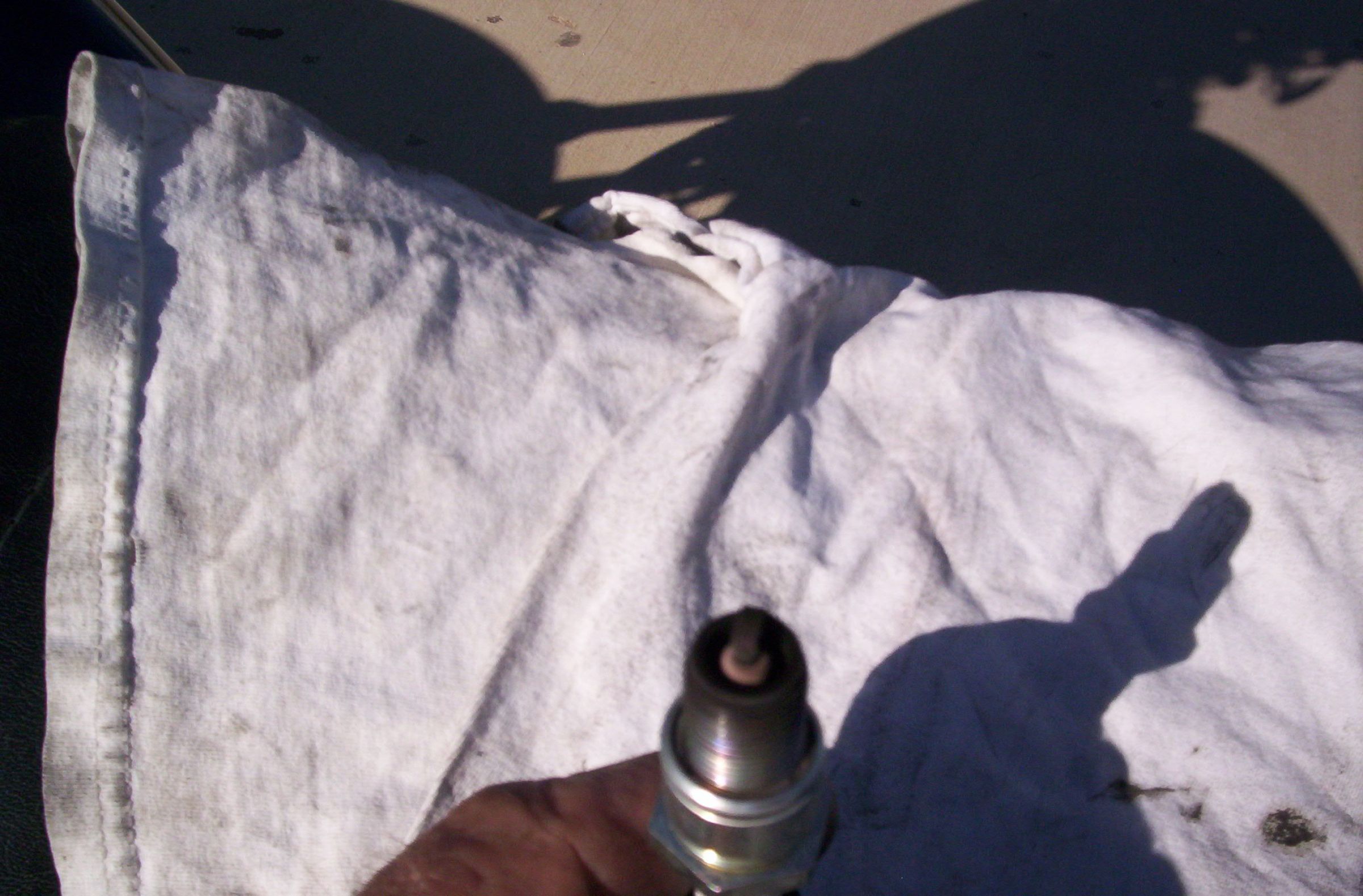

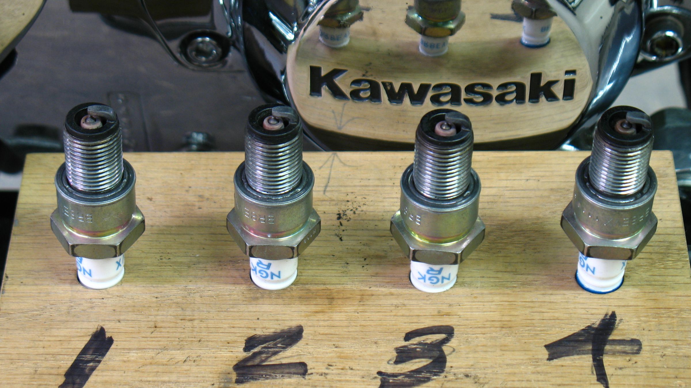

I checked my spark plugs after riding awhile with the modified air box (cover/snorkel removed), and here is what they look like after raising the 2 & 3 jet needles 0.5 mm (one washer):

They're period for the bike. That doesn't mean they are better. I'm making mine work no matter the cost.
You sure it's not oil on those plugs? I'd get it back to lean and start from there.

Not oil, but possibly fuel from too-rich mixture. Should I start with the pilot screw adjustments, and then the jets if needed?
It starts up great, and runs strong. I do get some backfires on deceleration, if the throttle is shut quickly. But not so-much when easing it down. Would that be caused by the immediate shut off of fuel/air mix when the butterfly valves are closed quickly?

Sounds lean by the popping on deceleration. Your plugs almost look like mine.
I know the mains were too big, being aftermarket didn't help. Went down one step. When I get home, I'll take a pic of what they look like today. Might have to go down on the pilots too. Did you raise the float level? Could be masking your readings.
