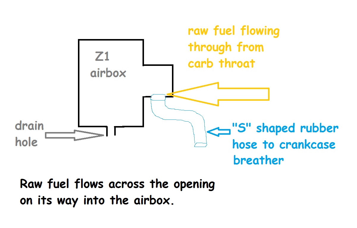

Some carbs have an overflow circuit.
Some carbs such as Mikuni smoothbores and some stock carbs don't have an overflow circuit.
Where an overflow circuit is functional (not clogged), fuel that rises too high inside the float bowl due to a leaking float valve (or for whatever reason) is usually expelled before reaching the carb bore.
Where there's no overflow circuit or a clogged non-functioning overflow circuit, fuel that rises too high inside the float bowl due to a leaking float valve (or for whatever reason) can reach the carb bore, and then flow both ways -- toward the back (air intake side) and/or toward the front (engine side).
With an airbox, some models such as Z1 allow fuel from the carb bore to drain via the stock crankcase breather hose directly into the crankcase. [With thanks again to Jeff Saunders
of Z1 Enterprises for his kindness years ago in taking the time to personally explain this to me.]
The following image is for illustration only, and is not to scale:
With carbs having no overflow circuits, it's especially important to assure properly functioning float valves.
For example, if while riding, fuel rises in one carb due to a non-functional float valve, and reaches the carb bore, which floods a cylinder so that the cylinder no longer combusts and allows some incoming raw fuel to drain into the crankcase, continuing to ride keeps allowing more fuel entry into the crankcase.
Fitment of a good aftermarket in-line fuel filter should help keep the float valves in good clean serviceable condition.

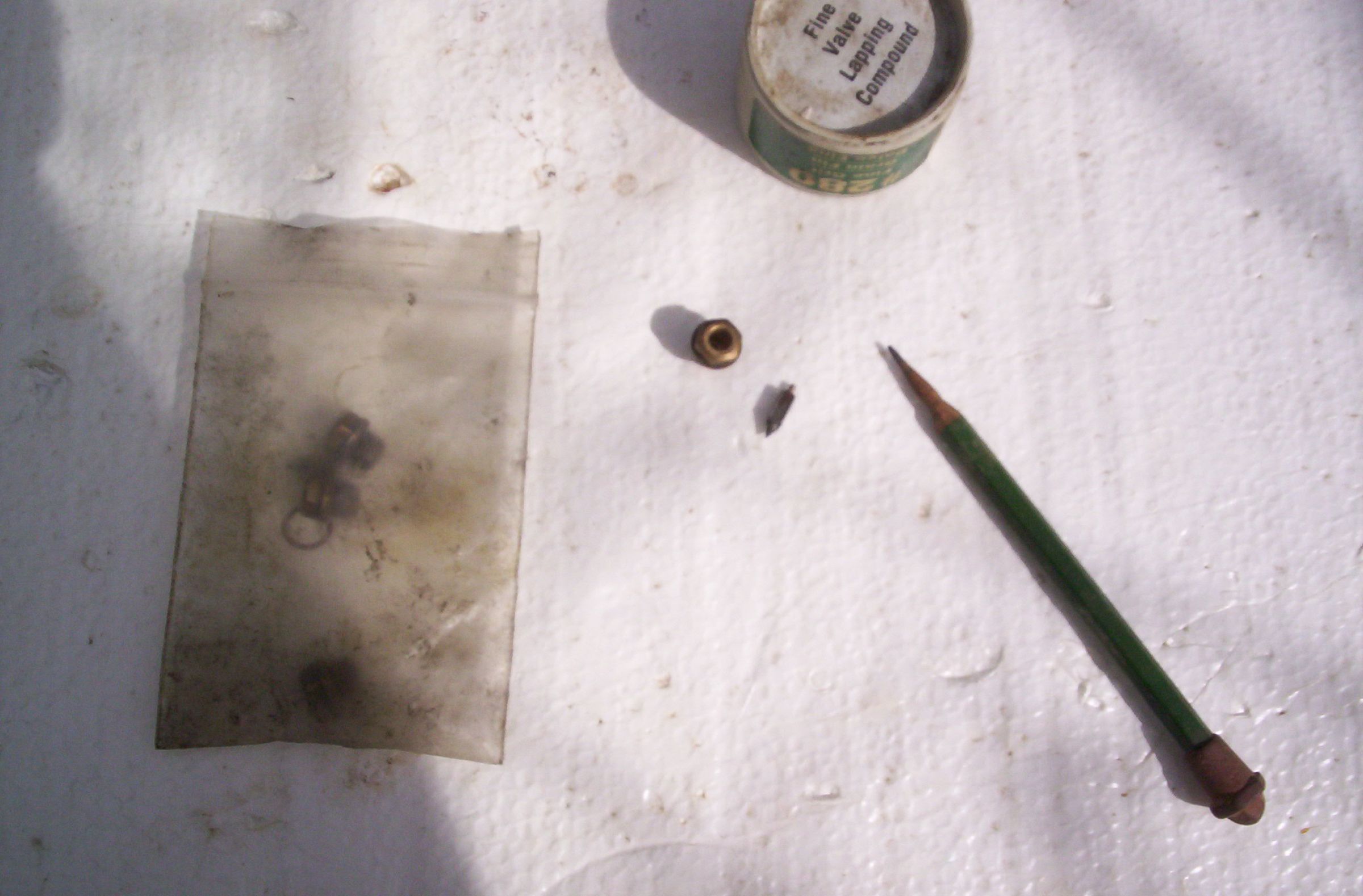

The Z1 air box has a drain that is lower than the breather tube. The KZ 900 air box gas two like mine. They're more for water than anything else. It is possible gas can get into the engine if the leak is really bad through the intakes. I had a needle and seat that wouldn't seal. I put the needle in a piece of tubing, spun it with a drill on a flat stick with #600 paper until the grove was gone. I had to whittle a # 2 pencil so it would fit inside the seat, used fine grinding compound to refinish it. The pic shows a VM 28 seat and you can see the line it made on the pencil. The 33's are much larger. You an barely see where it sat. It's been working for a year now.

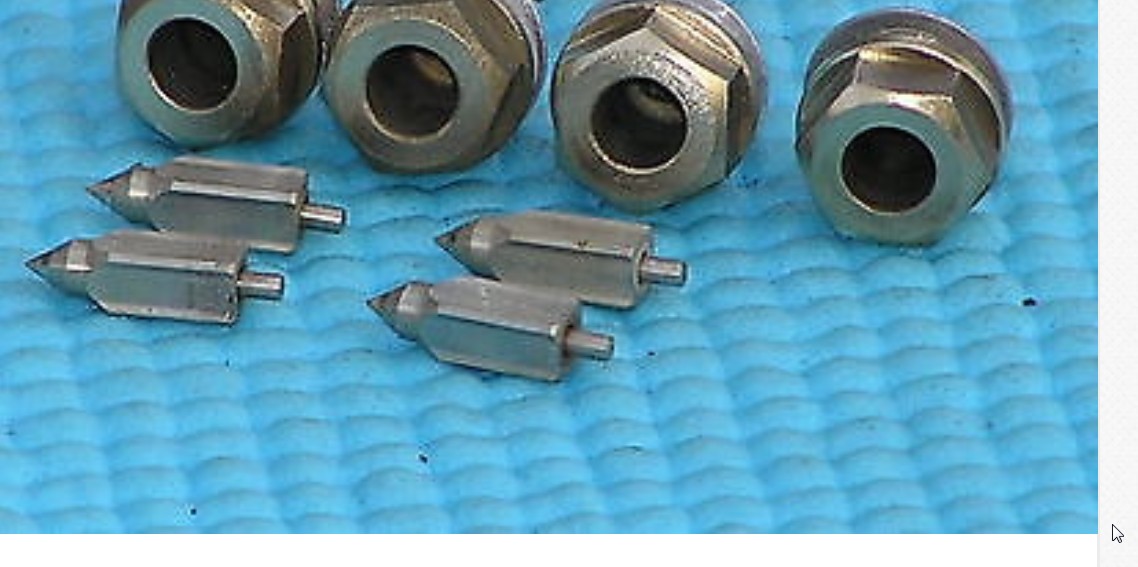

The pictures show the wear rings where the needles ride the seats. That's what you need to smooth out to get the perfect taper again to get a good seal. Put the needles in a hand drill and use some 400/600 paper on a popsicle stick to polish the taper until it's good again. You can also spin the brass seats and use a Q tip to polish the insides with a bit of chrome polish. make sure the seats are dead smooth and free of any burrs or rough spots. Put a bit of masking tape on the threaded portion to protect the threads.

05 Mar 2016 01:46 - 05 Mar 2016 01:47On mine I had a popsicle stick tool I made by narrowing it until it just fit in the seat and then snipping the end to match the taper of the needle's head. I would spin the brass seat and push the stick in after I dipped the end in polish.swest wrote: I had to whittle a # 2 pencil so it would fit inside the seat, used fine grinding compound to refinish it.

Thanks! I'll try. I don't understand how to center square valve needle in drill chuck.

A piece of tubing.

05 Mar 2016 13:26You can wrap it in tape or put it in a piece of rubber hose.car5car wrote: Thanks! I'll try. I don't understand how to center square valve needle in drill chuck.
