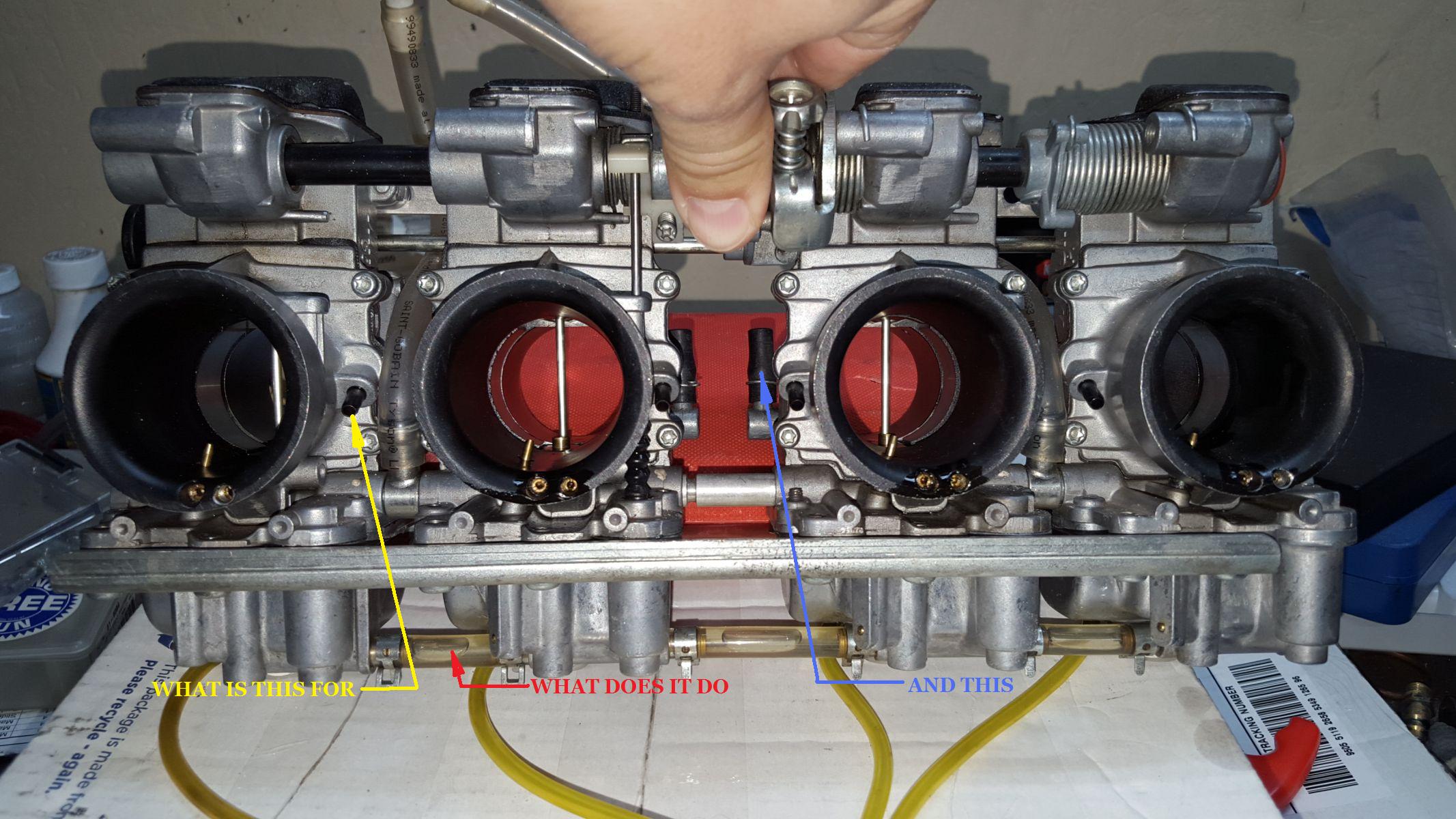

I see...
So there is no practical way of draining the fuel without it spilling all-over the top of the motor, and then one must have some gizmo setup to check the float level with a clear tube? :unsure:
Please correct me if I'm full of gas. :blink:

I catch the gas in a container. Most bikes don't have the luxury of a drain screw and nipple.

swest wrote: I catch the gas in a container. Most bikes don't have the luxury of a drain screw and nipple.
...luxuries standard on the BS34's :huh:
So nobody has come up with a new threaded plug with a nipple? Dang nipples anyway... :pinch:

Yellow, bowl vents, red, balance tubes, blue, vacuum ports

These are set by float height, I will take a cap of and see if I can figure out the thread size. I am sure it is metric so I'm betting you would have to buy a spare and put a nipple in it to use it for clear tube method.

baldy110 wrote: Yellow, bowl vents, red, balance tubes, blue, vacuum ports
There is no apparent provision for utilizing the clear tube method for measuring the fuel height in the bowls.
Let me guess...clear tube is connected to one balance tube nipple while the other is plugged on each bowl, while the carb rack is mounted to a level support on a bench. :whistle:
We are all aware that the clear-tube method is preferred to all others to accurately establish fuel height, so let's hear it guys...how do you who have these carbs deal with what seems to be a mystery here? :whistle:
1982 KZ1100-A2
