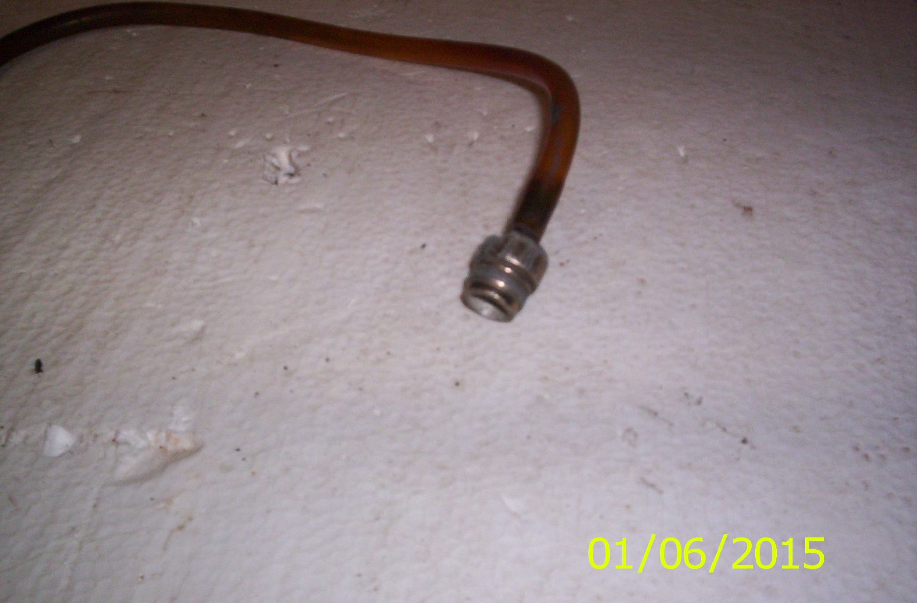

Is there something to attach a piece of hose for checking the float level, and draining each bowl independently?

The BS34's have a convenient drain screw and nipple at the base of the bowl, to simply attach a piece of clear tubing. Is that not an option with the RS models? :blink:

My 33's have a large bolt at the bottom for quick access to the main jet. No drain or overflow. From what baldy was saying they have it too. The main jet sits in the bolt/cover so it has to be deep enough> I guess a rubber cork could be used if it is drilled to fit and a tube inserted.
