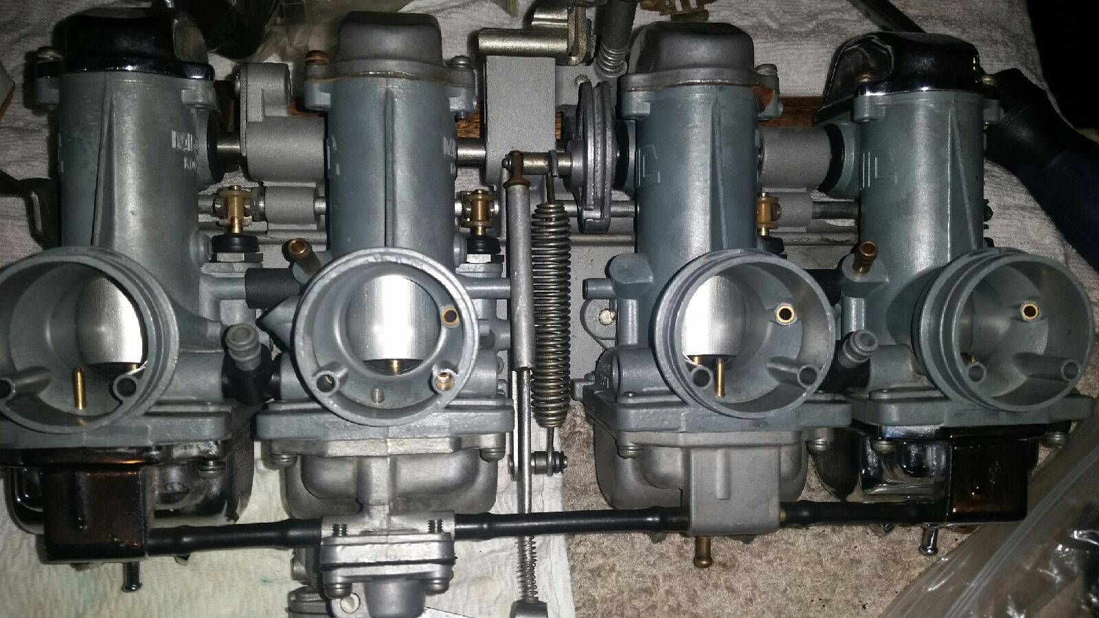

Need info on Carbs

Vm26ss from a 79ltd? What size are the throats?

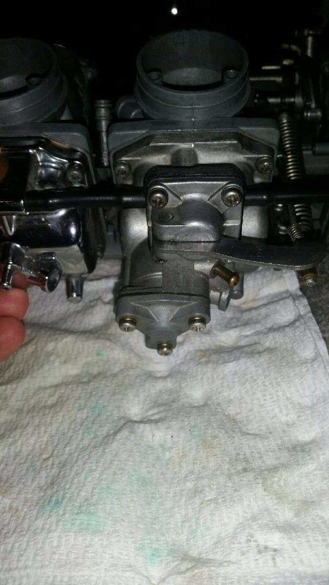

26 or 28mm pumper carbs. Only 1 pump, it has the lever.

The triangle cover isn't on the 28 pumpers just open space

They are 28mm .
And meant two diaghrams
They're not mine but a friends.

Canadian 28mm possibly

I have seen the extra diaphragm on the canada pumper models but not sure about the double fuel inlets do you have a pic of the bore side

Don't have a pic but friend says it measures 28.70

30 Dec 2015 16:29is your friends name mark?spdygon wrote: Don't have a pic but friend says it measures 28.70

check out this link. This leads me to belive those carbs are vm 26mm off a 79 LTD

So many parts are interchangeable, that it's possible these are not as they came on the bike from the factory. I have a set of 28mm carbs on my KZ1000A2 that have the single accelerator pump that came from a 1980, however if I swapped the float bowls from my 24mm double pumper carbs that came from a KZ650 then I would have carbs that loo like yours, including the dual fuel inlets..

Don't know....all I know is that my friend bout this thinking that they were 28mm pumpers.
Normally they have single fuel inlet , one diaphragm and the idle screw on the bottom.
This measure 28.70 on the head side , have two fuel inlets , two diaphragms and te idle screw is on top.
