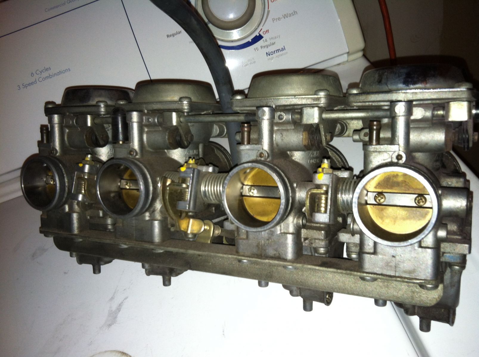

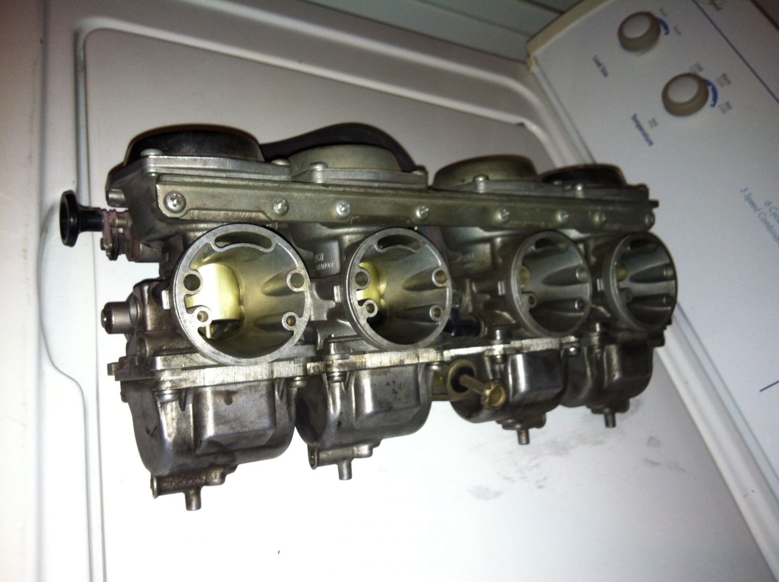

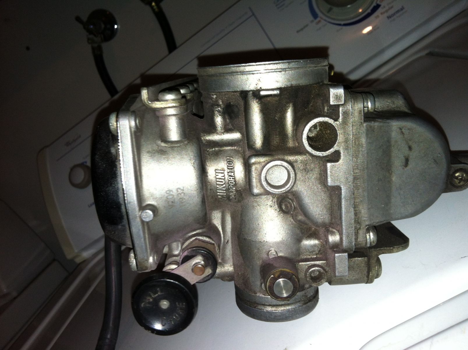

I have a set of carbs not sure what size they are how can i figure that out ? number on the carbs is v203 and h932 or do i just have to measure them

Post up some photos and measure the inside diameter of the throat where they attach to the head.

Welcome. What year and model bike do you have? Pis would help. You have a double thread, do you want one deleted?

They look good. CV carbs. Do you have a manual yet?

Mikuni BS34 CV type carbs. Kawasaki's adaption. Suzuki used similar but slightly different in the detailing.

Measure the other side/engine side.

18 Dec 2015 12:09I thought that the body and choke looked just like the two on my 750Nessism wrote: Mikuni BS34 CV type carbs. Kawasaki's adaption. Suzuki used similar but slightly different in the detailing.
