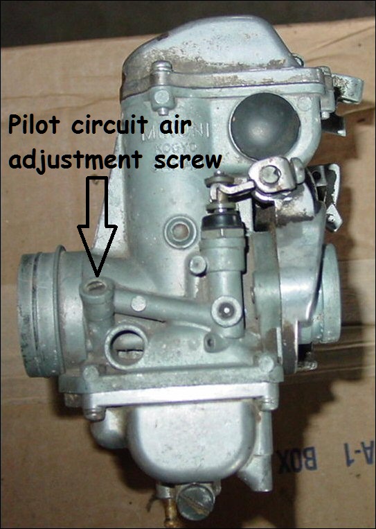

Assuming VM type carbs, it will help to understand if that particular model has the fuel screw on the bottom of the carbs, and/or the air screw on the side. The fuel screw typically should be set for 1 turn open, and the air screw at about 1.5-1.75. More specific info is needed before making too many recommendations though.

If it's a side-located pilot air screw, turning it in clockwise reduces air which further enrichens the mixture.
Two turns out is probably far enough out when carbs are in perfect condition.
