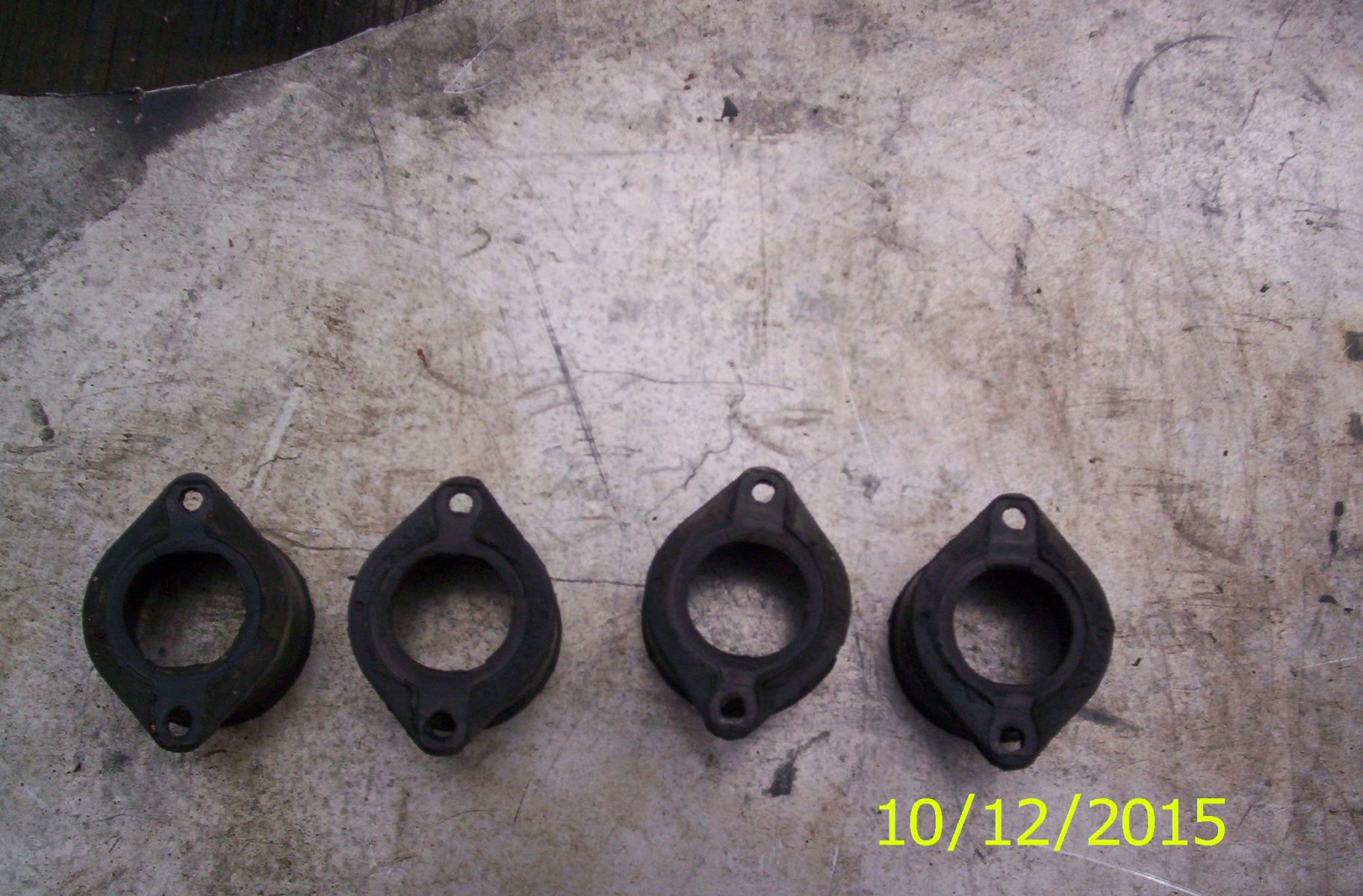

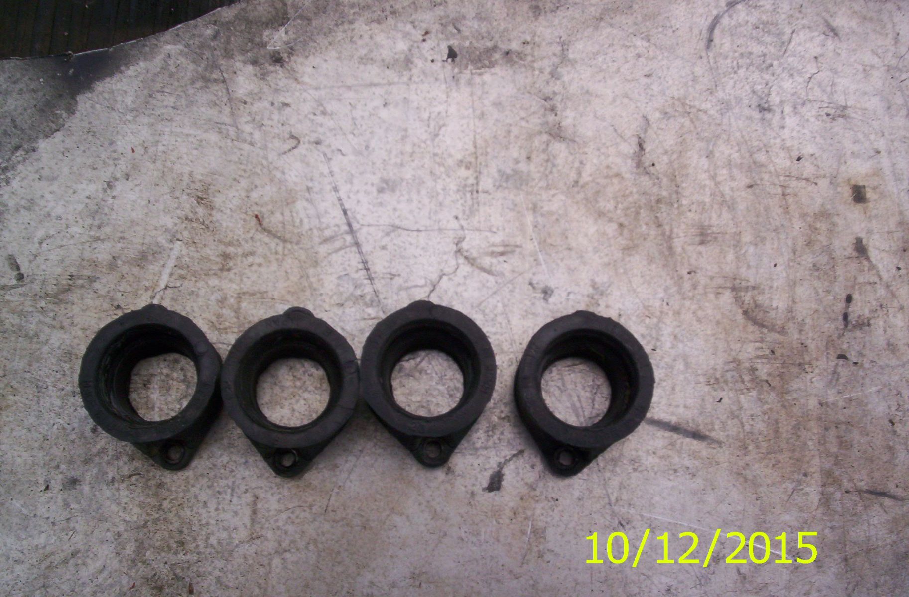

i removed and checked the intake boot, looks good. resealed it to head. cleaned carb again and blew air through ports, all clear.
i may try a compression test tomorrow, starting to think its inside motor. wtf
