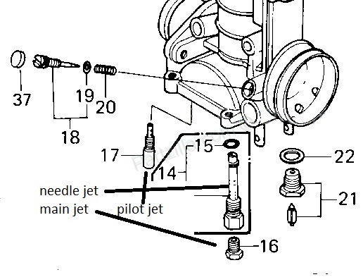

loudhvx wrote: His photo shows the jet holder sheared off in the body, and I think he said there is now a broken drill bit also inside of it. The area of the casting that has the oring seal appears to be damaged as well... so it's probably a paperweight at this point.
Someone on ebay is selling individual carb bodies. One body is not terribly expensive, but if you had to buy the entire rack, one piece at a time (including all the other hardware bits), at his prices, you'd be paying way too much.
I can't find this picture in this thread... never heard of this happening... always something new1

The carbs that I broke the needle jet ( emulsion tube) off is the American Style with the caps on the mixture screw.
