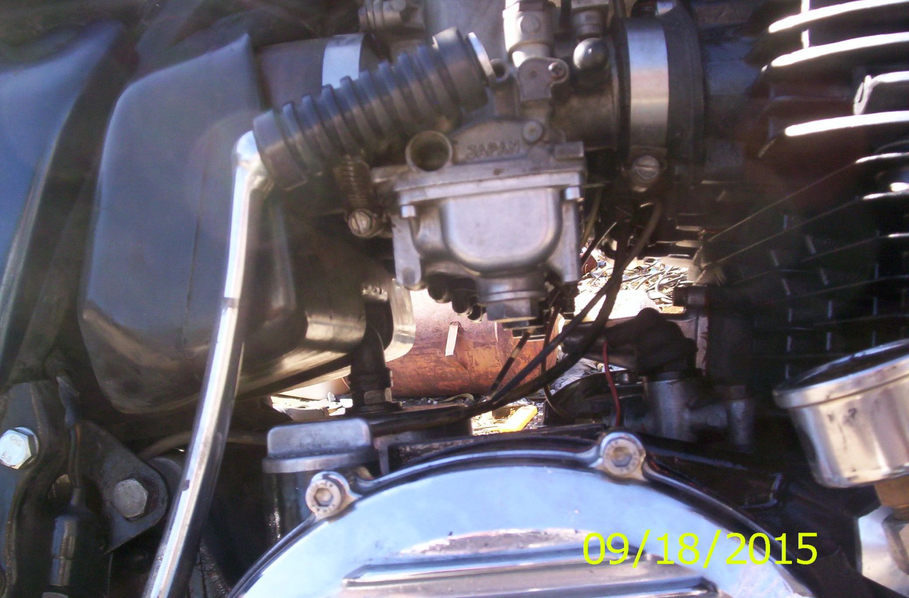

My first boots I made out of radiator hose I bought at AZ. I then got some sexy blue silicon hose. It's turning black anyway. If it fits the outside of the carb, they will be tight going into the box. Just be sure they are in the same length as the old ones.

Steve, did your outter boots elbow and point towards the inside of your airbox? Mine do. Did you try to curve yours also?

I didn't have to. My carbs are 33mm Miks. The air box is from a KZ 900. I had to open the holes more to fit larger boots. I just angled them slightly with my cuts inside and out.
