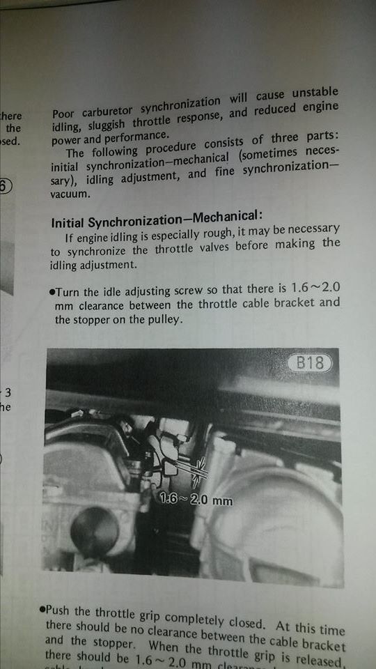

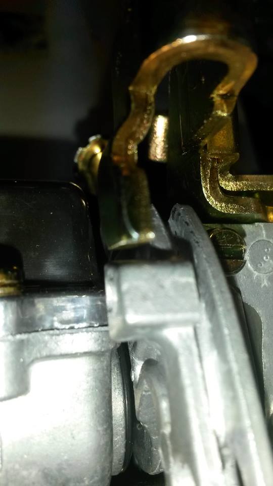

the book calls for backing off the Idle screw so it's up against the stop but mine will not go to the stop and the book calls for a new bracket if
it won't.
will backing the slides off close this?
it won't.

Yes, your slides are all catywompus. Put the adjuster in the middle and set your slides with a drill bit as a gauge on the bench. :whistle:

I believe I got it. Misunderstood what the book was sayin
