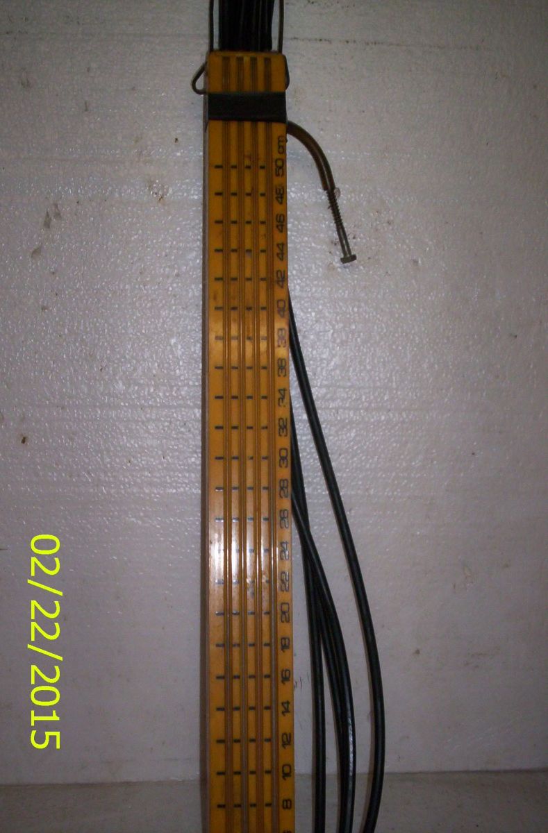

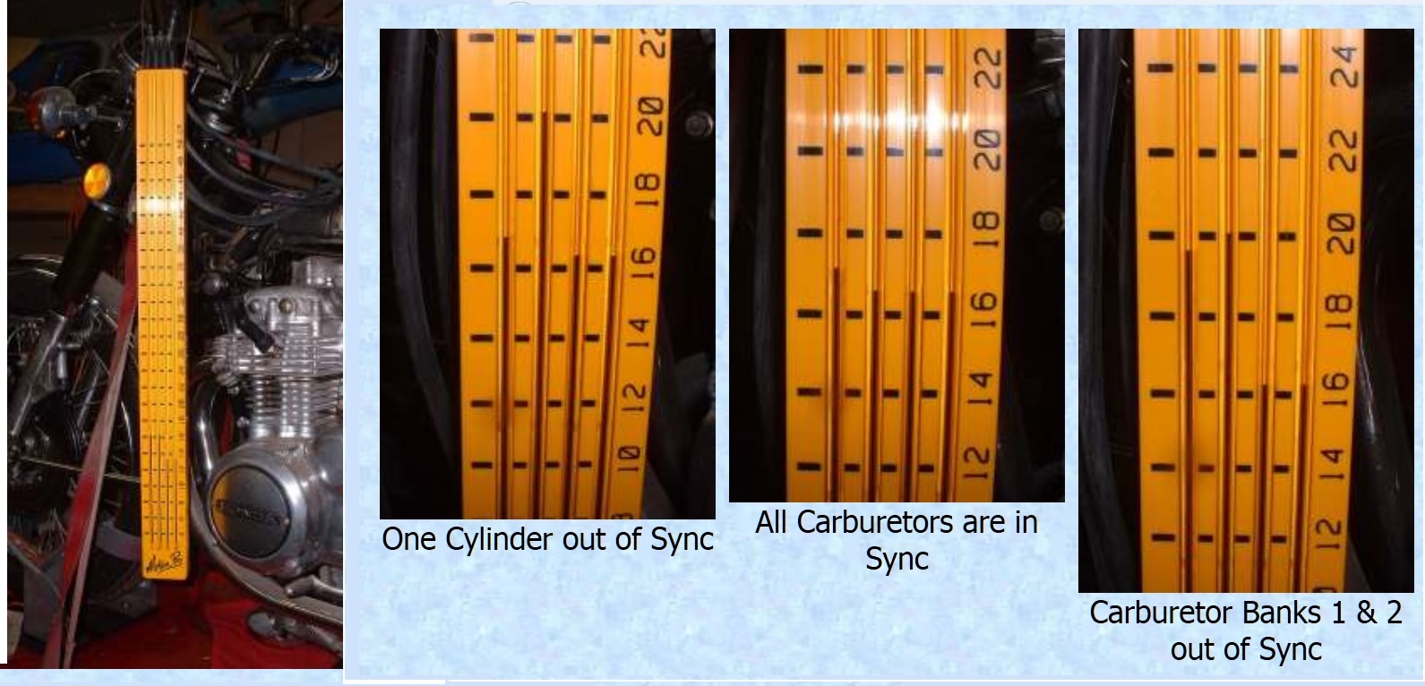

I've sync'ed carbs numerous times. I follow the book (see below), and it doesn't have you rev up the engine at all. The entire process is done with the engine running at idle speed, Trying to sync the carbs with the engine running at higher rpm will not work. Ed
Attachment 00003a-112.jpg not found
Attachment 00003c-16.jpg not found

When the manometer shows equal vacuums at idle rpm, the throttle may be lightly blipped to assure that the equal vacuums remain the same when the throttle slides click back down.
Be very careful not to over-rev, as over-revving can suck mercury into the engine.
A safer method could be to simply turn off the engine -- no throttle blipping -- while the manometer is showing equal vacuums at idle rpm. While the engine is off, open and close the throttle a few times, allowing the slides to click down. Then start the engine to assure that the equal vacuums remain the same at idle rpm.
