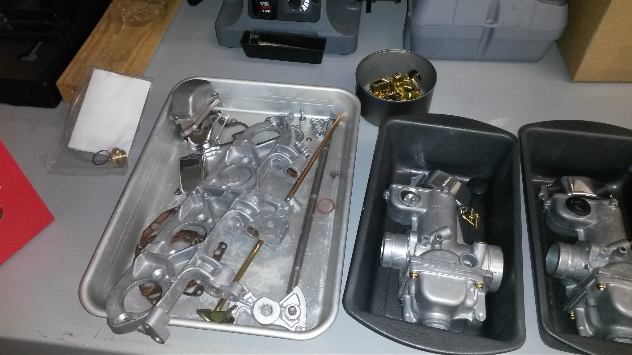

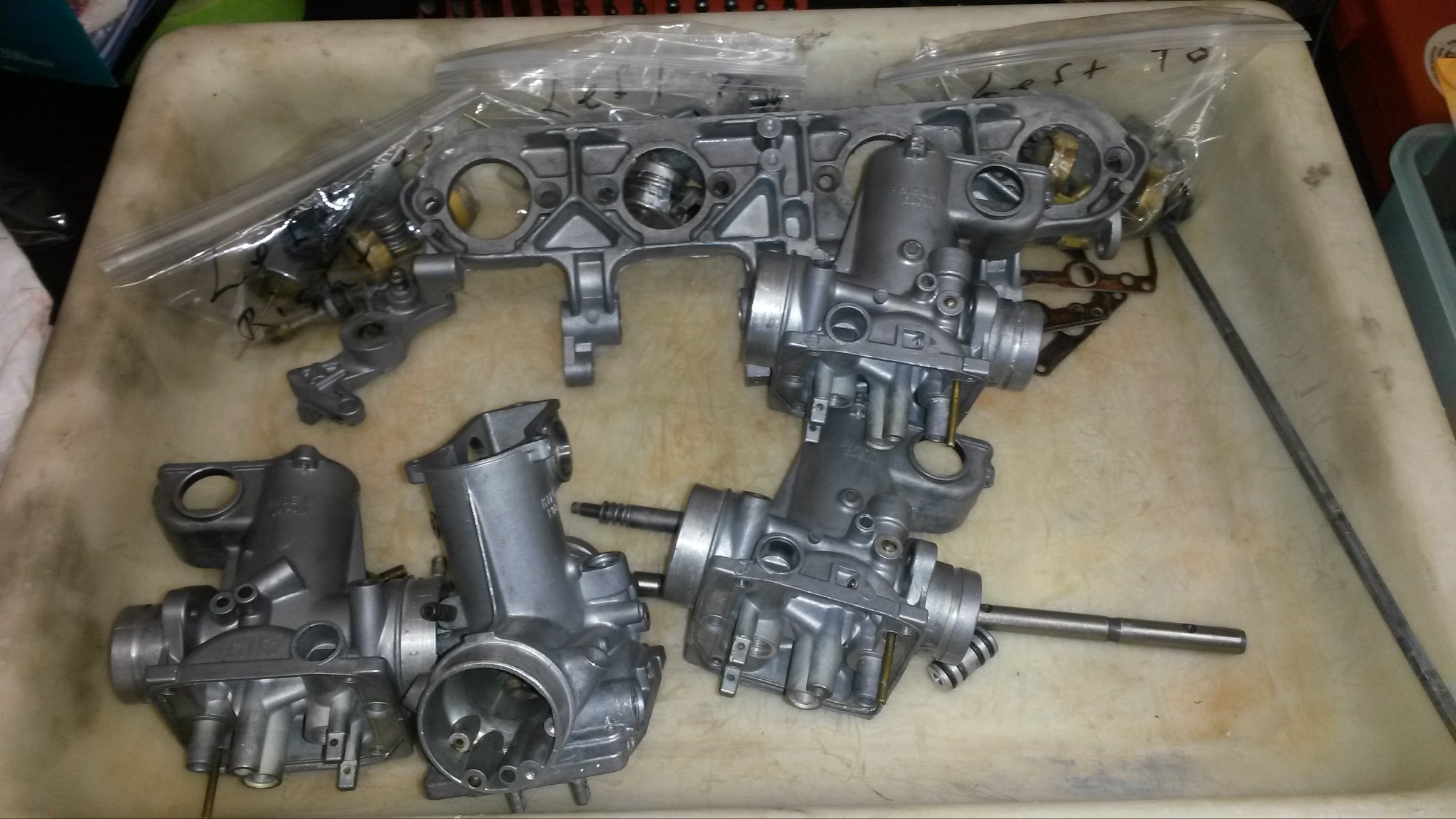

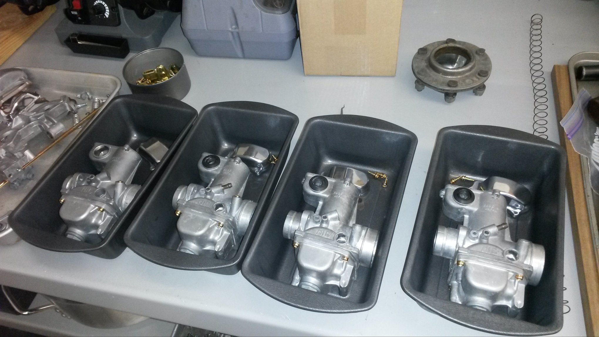

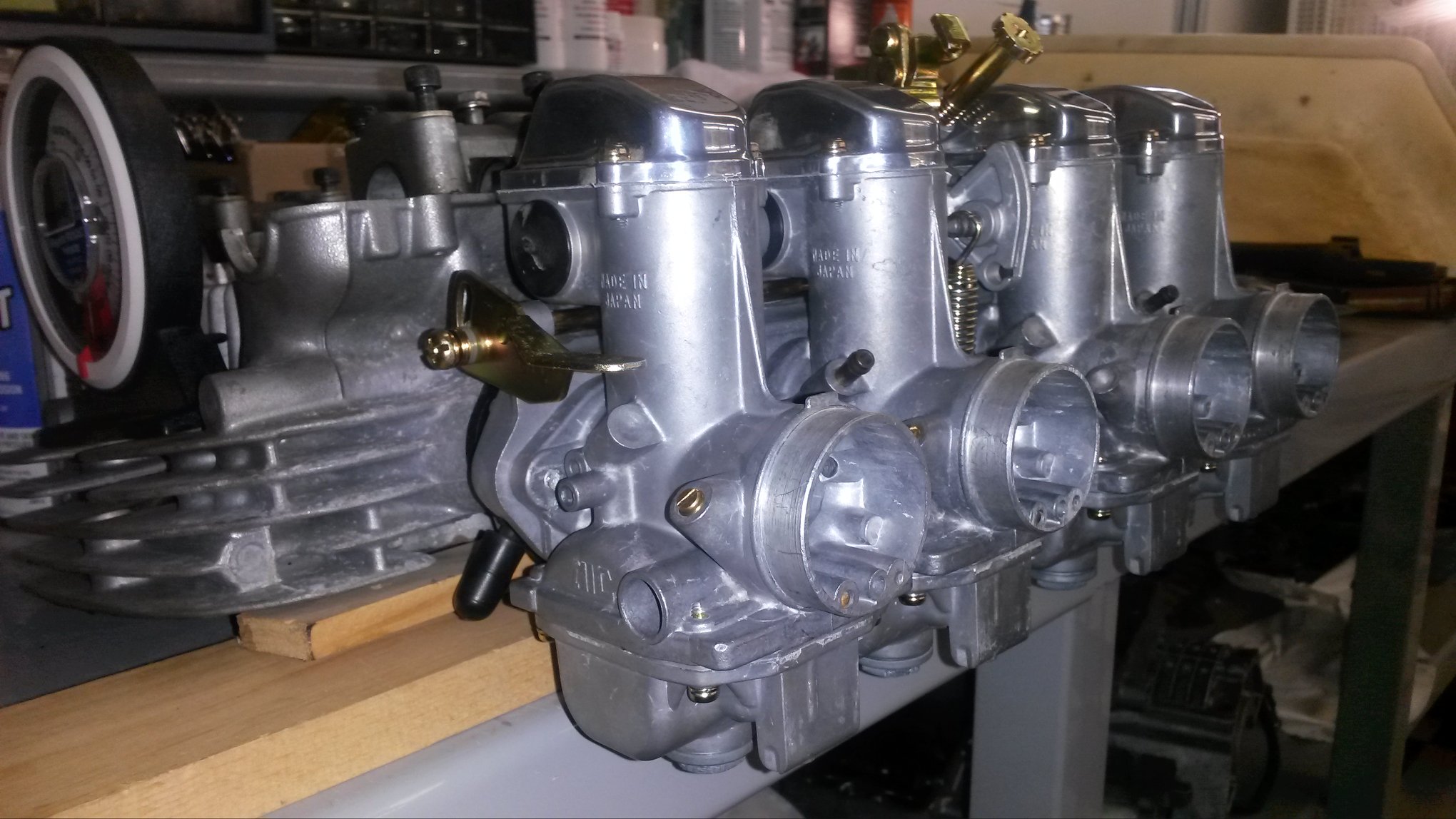

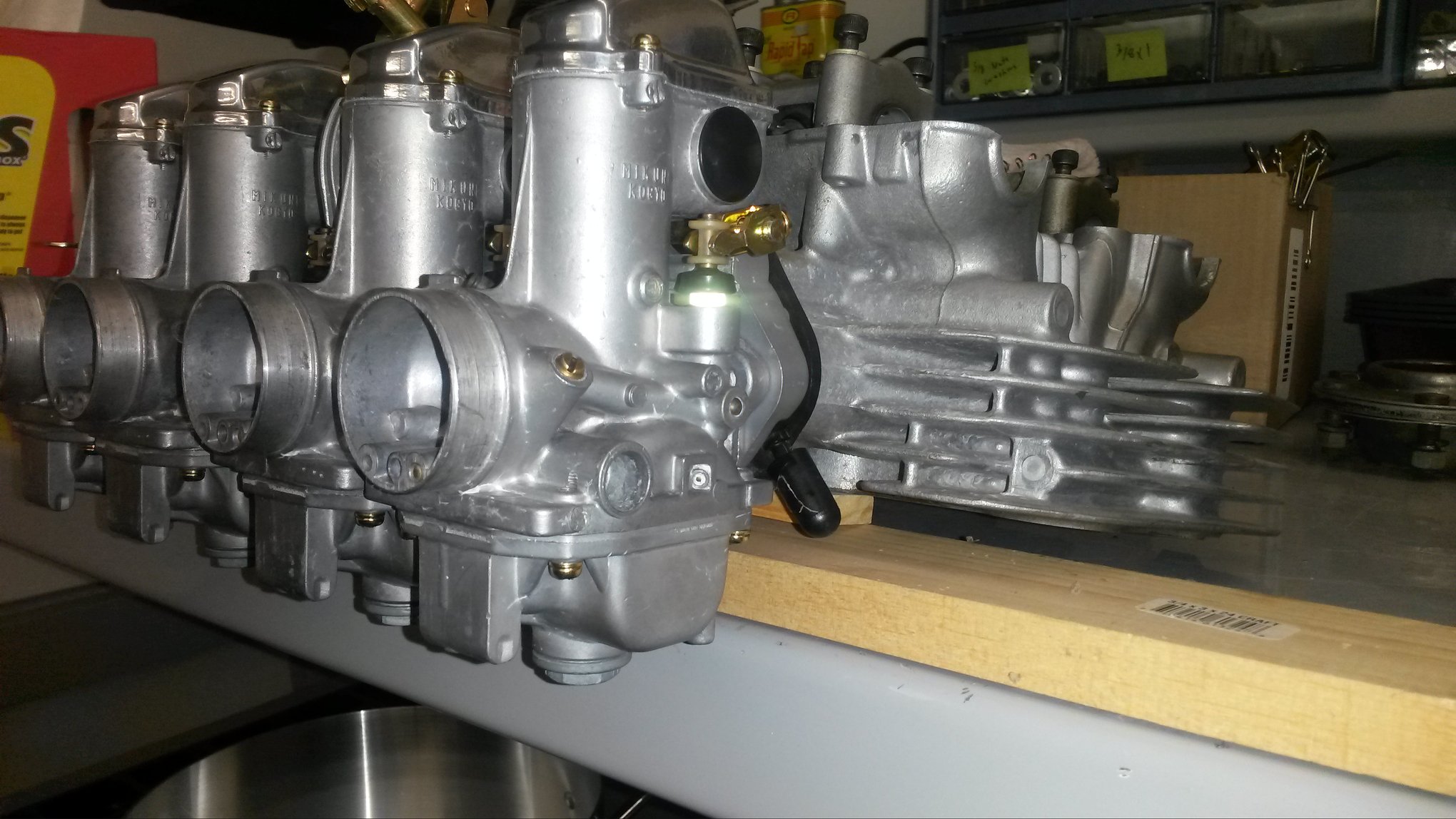

My first attempt at rebuilding carbs.

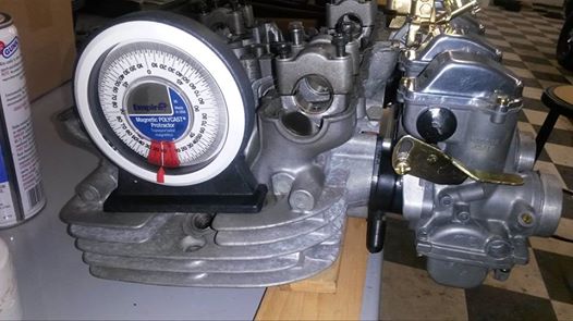

So far everything went pretty good. I checked the float level when I got em back together by setting up an old head and using a protractor and measuring the motor on the bike then blocking the head up with the measurement on the table.
Next get em back on the bike and sync them in.

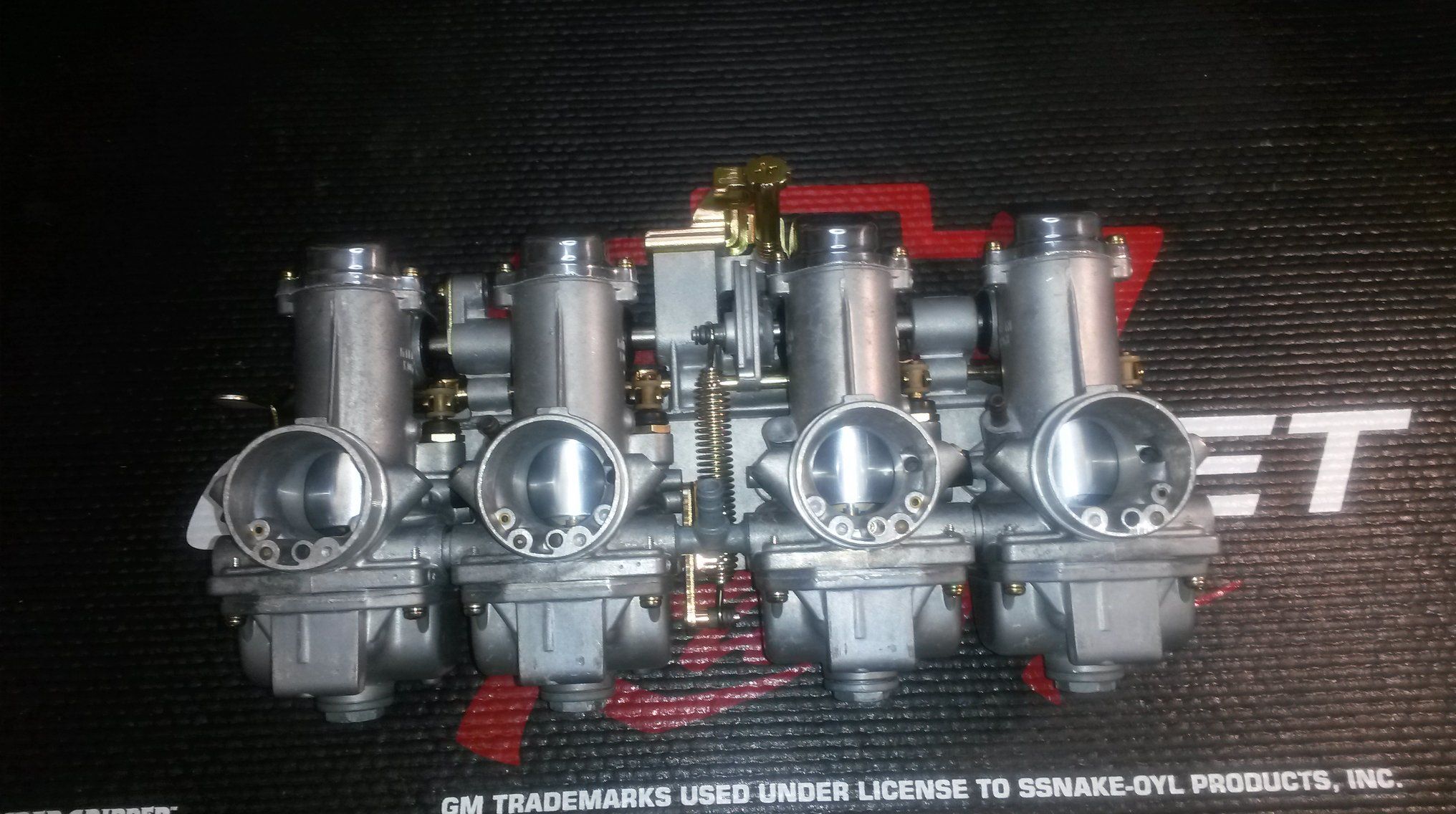

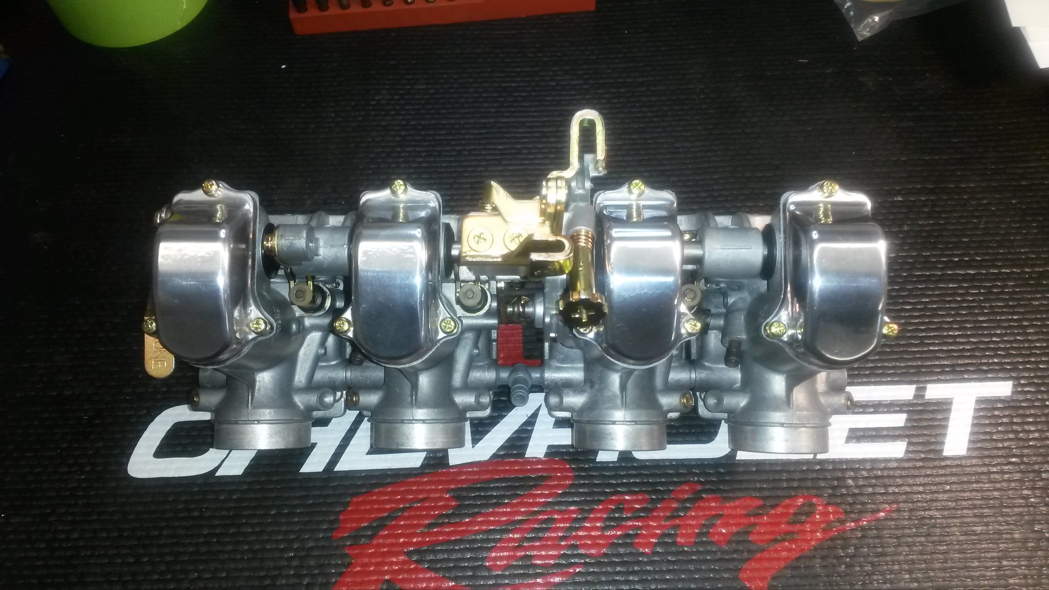

Nice resto!! Everyone's wet dream here! On the site!
29 smoothbores!
Did you do the gold cadmium yourself? Like with an Eastwood kit? Or send them to a plater? Or where they that nice?
Did you sync your slide levels first? I always put a piece of 1mm copper wire under the slide opening. Do a pull thru, and get all 4 open equal.
It helps with the fine tuning. And was that vapor blasting on the aluminum? I always used sulphuric acid H2SO4 diluted to dip my aluminum.
But Nice! I want a set that nice! Here is the last set I did.
I see your float tool! From Dave? "gunsmith blue" Dave makes nice parts cheap! I bought his other one for the small side drain pugs.

21 Sep 2015 20:02A friend that does brake boaster's got em done for me. I would like to try one of those kits.z1kzonly wrote: Nice resto!! Everyone's wet dream here! On the site!![]()
29 smoothbores!
Attachment 000_0010_1.jpg not found
I didn't take the slides apart was hoping they'd be close. Would just taking the slides off the shaft change anything?
Yes and I emailed him to see if he had the plugs without the hose nipple. I like the look of the brass plug and the threads seem better then the stock one's.
I used a sonic cleaner I'm still learning with it but so far I'm happy with it.
I've seen those vapor blasters they do a great job.

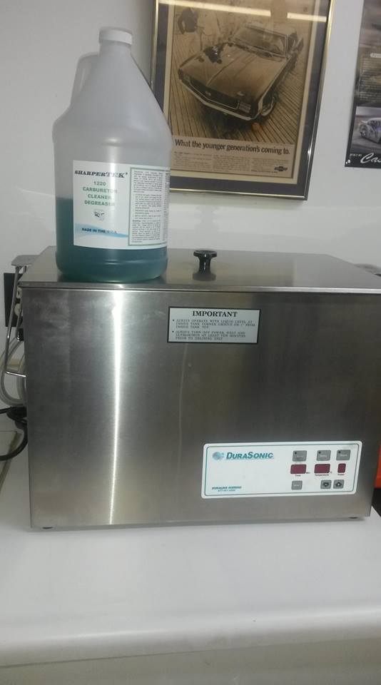

21 Sep 2015 20:07baldy110 wrote: Wow Eddie they sure are pretty, how did you clean them?
Paul I got one of these. So far I've done one shotgun and one set of carbs.
I really like the job it does so far.
