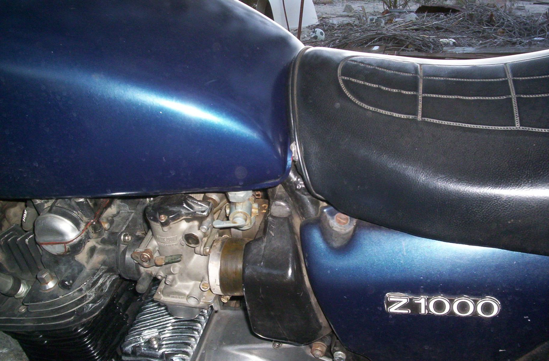

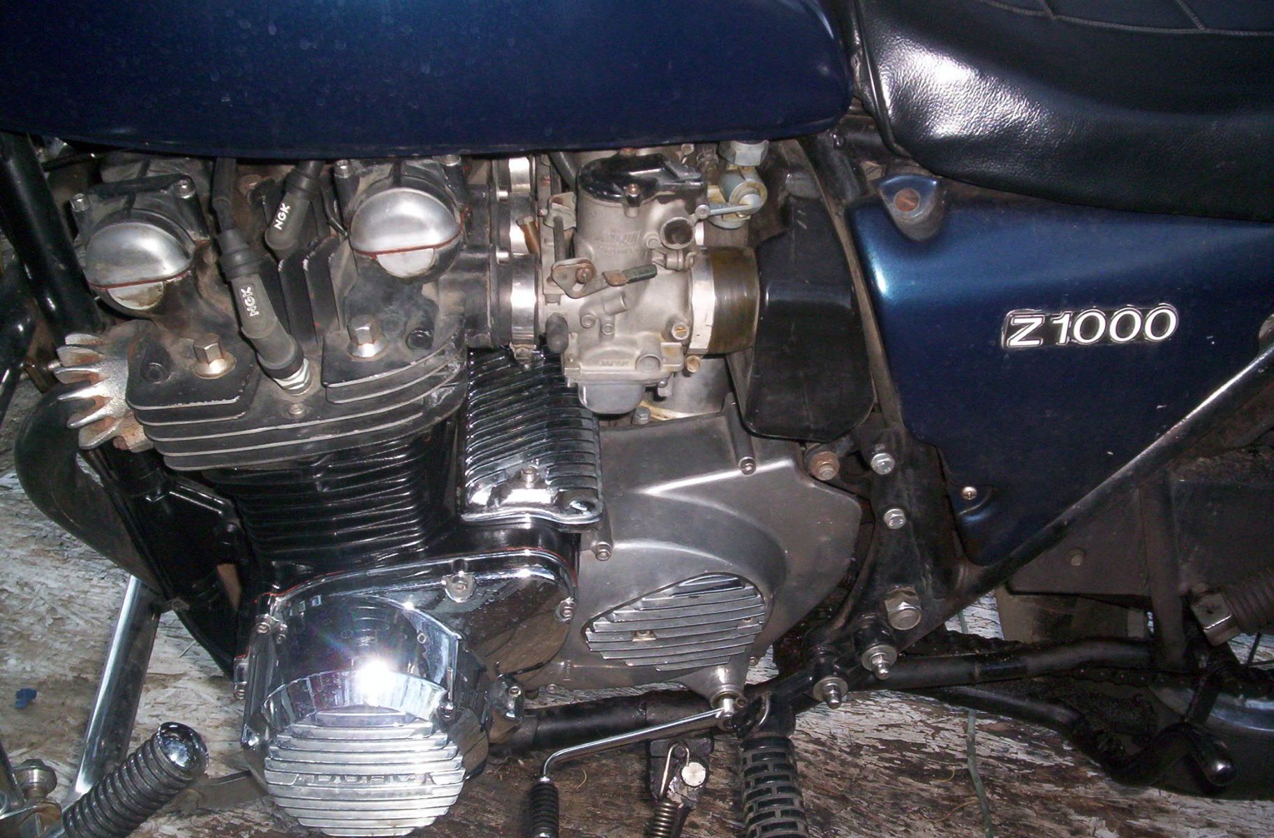

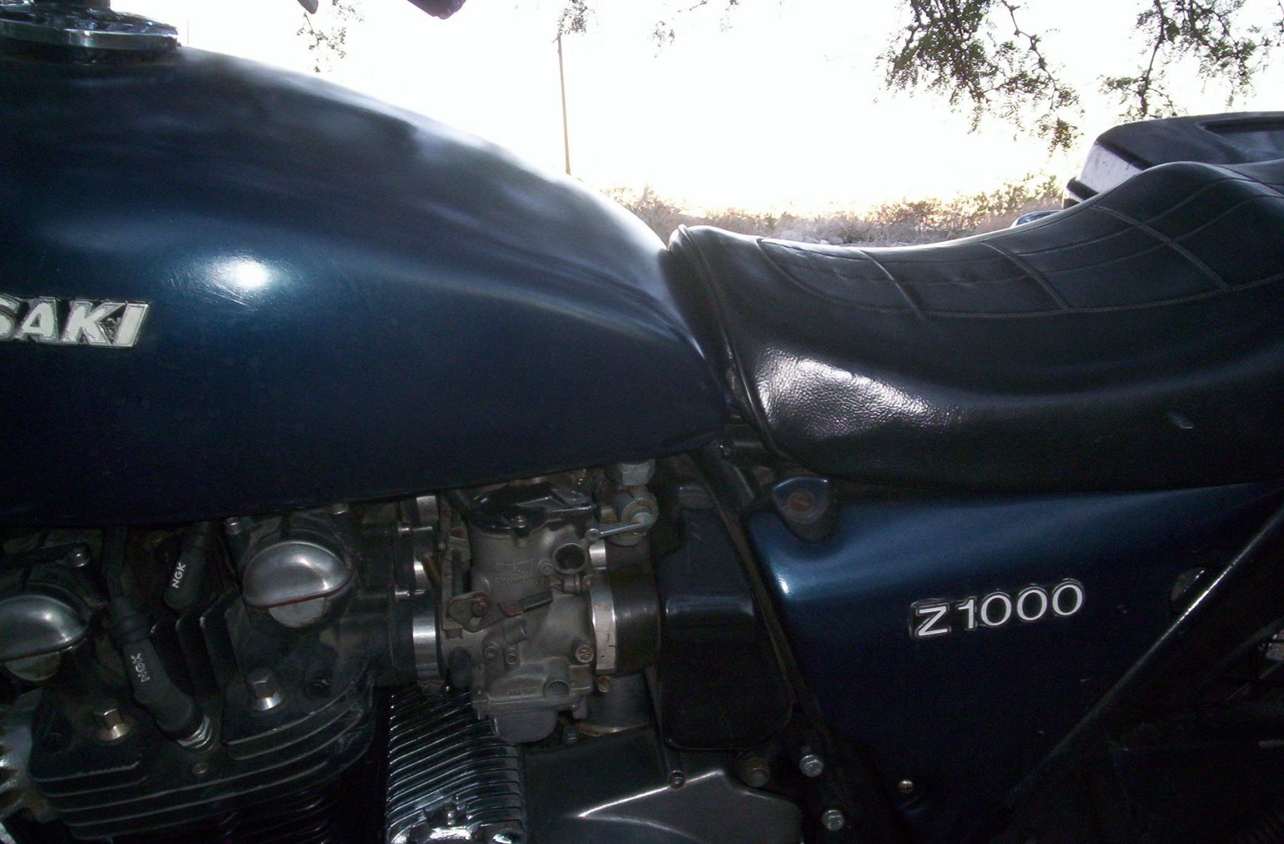

Not to mention fitment issues. My 33's are much bigger than the 28's. Had to buy bigger carb holders, make bigger boots, use a KZ 900 air box with the holes enlarged and make new boots to fit. My petcock barely clears the carb body.
Oh and my pretty silicon boots? I should have gone with the black ones.
