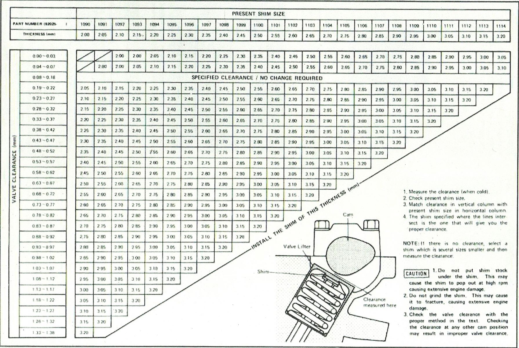

You have shim over buckets. You need the tool to adjust them.

Thank you for informing me before I got into them. I looked one up they are not high at all.

No eBay APP ID and/or Cert ID defined in Kunena configurationIf you're careful you can reuse the gasket. I always have a spare on hand.
I get all my gaskets from him. Quick and if damaged, he'll send a new on. Good guy.
You won't regret it. jetsRus has shims or your local bike shop might trade with you for $5.
