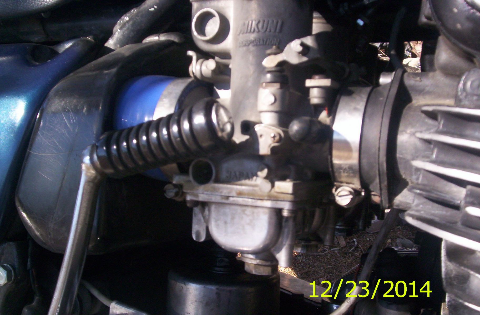

It occurred to me today, that maybe I ought to try a little harder to nail down these carbs identities, before I continue to throw money at them. They are Mikunis, and the numbers/letters stamped on the flanges is Z12, and this is over 00. Kind of like a fraction from hell :ohmy:
I measured the intake side of the carb throats and the I.D measured vertically is less than 27mm, and when measured from side to side, is approximately 26.6mm. The covers on the tops are three screw. Can anyone id these?
Also, they came (to me) with 117.5 main jet, which I left in, and 15 pilot jets that I changed to 17.5. The bike has the pods, and the four into one Vance and Hines exhaust.

close up pics will help folks identify them.

Sounds like VM 26's. Came on KZ 900/1000. Good carbs but if you're going HP, you'll need bigger ones.

They are the factory 26mm carbs. If your bike only has the pipe and pods they will work fine. Even one up on cam and you will be fine. But like other person said.. They will eventually need to be changed to allow more air flow if you plan much more.

Thanks for all the replies, definitely need the help right about now. I took a couple of pics with phone. I have no immediate plans for any performance mods...what you see is what it is (for now:))
