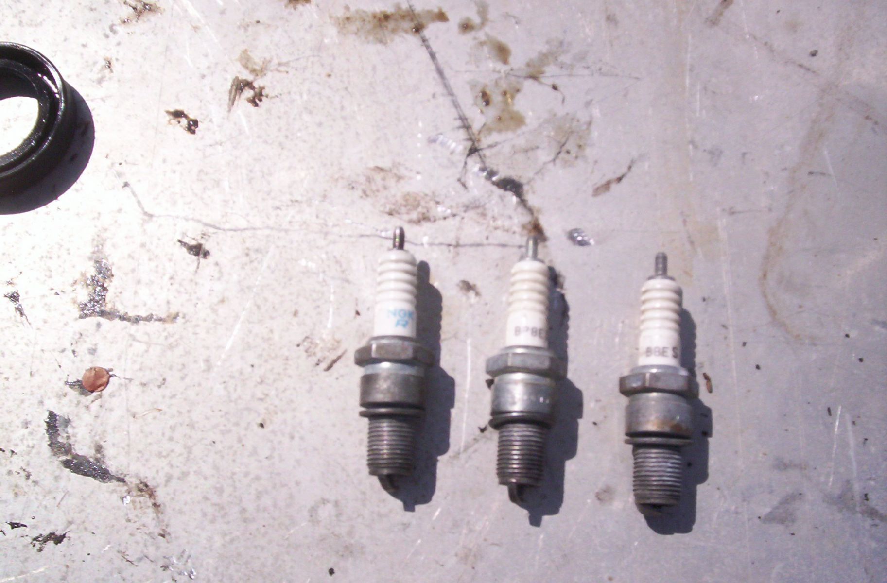

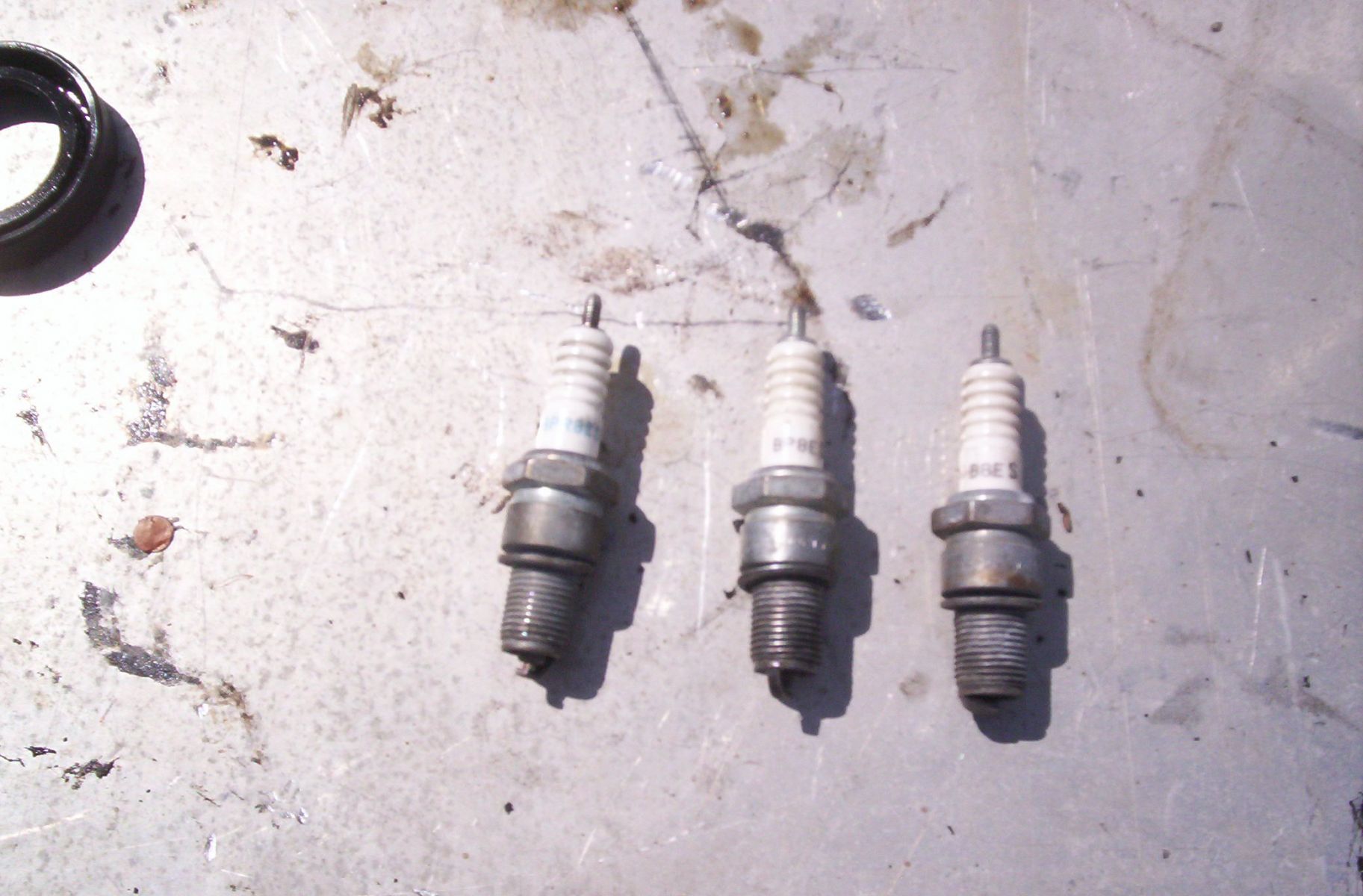

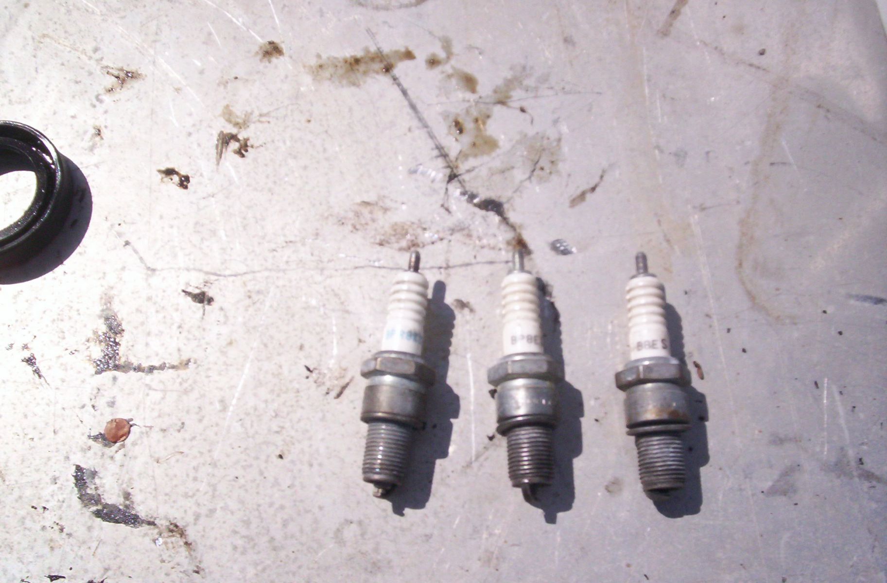

No mention on adjusting the valves. Those plugs are BP style plugs. They have a longer reach than stock plugs. I used them when I was fouling plugs due to bad valve guide seals. I could tell they were causing more problems than they were worth so I changed to a normal reach plug, just platinum. I doubt they are the correct heat range ether. Suggest a set of plugs, then go from there.

what is a BP style plug?

- Posts: 23574
- Thanks: 2954
Re: Pods, Tk carbs, struggles
01 Sep 2015 20:16 - 01 Sep 2015 20:19kawi810 wrote: what is a BP style plug?
Here's the difference between the two. The BP's have a longer reach.
