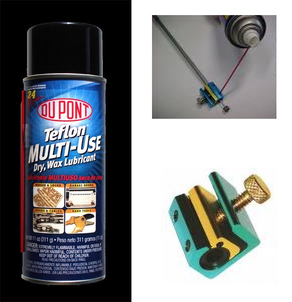

Varying idle rpm might also be due to a mechanical issue with the throttle cable, anywhere from the handlebar twist mechanism to the connection at the carb bell crank, or a slack adjustment might be needed, or maybe the interion cable is frayed, or throttle cable needs lubing, etc.

Havent done a valve adjustment, was thinking that i should sort the carbs first, since that was something i could do on my own right now and didnt have to use a shop. The bike have been sitting for aprox 7 years so i guess i have to try lubing the gas wire and checking if the slides are sticking. i did not use sealant on the carb holders just put them on dry as i was told to do.. the old ones did not have a gasket or sealant either. torqued the bolts to spec. pilot screws set at 2 turns out as specified in the FSM
