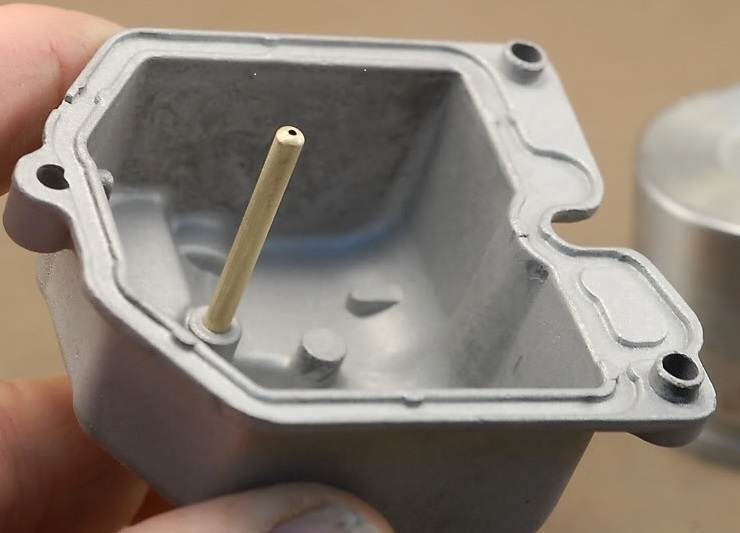

Here's a typical overflow tube rising up from bottom of float bowl.

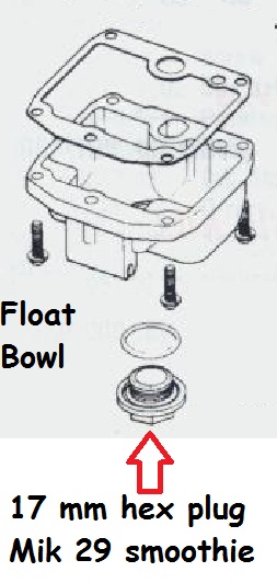

Some carb designs do not have overflow circuits, hence no overflow tube.
Mikuni smoothbore carb is an example of a manual slide carb design without an overflow circuit.
