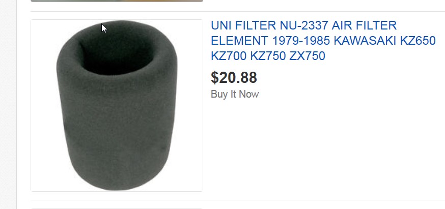

I have been running an aftermarket foam style filter (on aluminum frame) for about 30 years now. You oil and clean it at regular intervals and it lasts forever. I think they used to sell for maybe $20.

Mine is like this one. I use the "no toil" filter oil and solvent because it is biodegradeable and dissolves in the water based
solvent solution. You don't have to use any paint thinner or mineral oil,

I'm running a K&N now but I would not buy one today if I had to change it. That you can clean it and apply new oil instead of buying new is not worth any extra price. My girlfriends Suzuki is born with an oiled foam filter that is cheaper, filters better and also last a lifetime. Really it comes down to if you want that extra amount of airflow (that some tests says are a pretty dubious claim in real life) and can live with a higher wear of the engine since it will let more dirt through.

I've used both the K&N and Uni filters in my bikes for 30 + years with no problems or accelerated wear. I think the Uni foam filters do a better overall job. Go to the Uni site and see if they still have a filter for your bike, they normally cost less then the K&N's.
