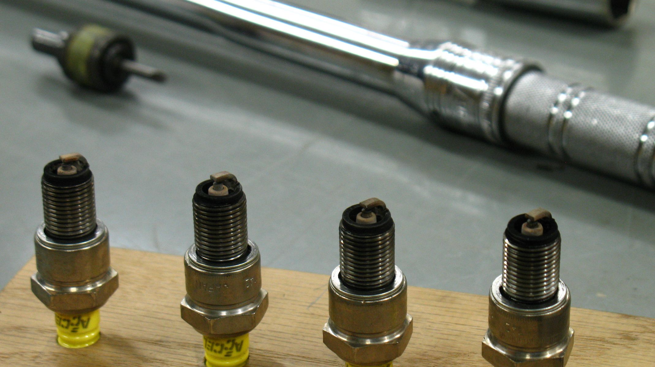

Just completed my KZ(?) 1100 top-end build with 84 GPZ cams and ZN 1100 "Bath tub" head over a low mi. cylinder block with new (modified) oem standard pistons and rings...with new pins for good measure.
It has the factory air-box still, and the original unmolested BS34 carbs with 42.5 pilot and 132.5 main jets.
Here is what the spark plugs look like today, after the first 600 miles.
Back to 40 pilots per LarryC suggestion that plugs look "quite sooty". Will start with the pilot screws adjusted to 1.5 (vs. 2.5) turns out, and see what happens...

Looks like you got them dialed in pretty good. was the factor pilot jets 40 or 37.5?

37.5 pilot (factory) :laugh: :whistle:
