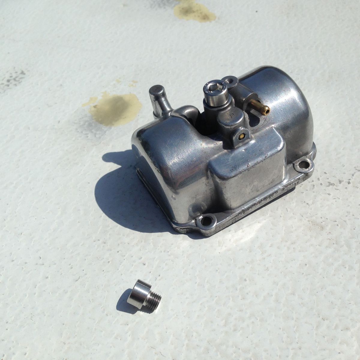

I'm finishing up rebuilding the BS38s on my 750G. One of the main jet plug screws was missing and the other was roached. This screw is M6-0.75x8mm. I can seem to find any M6 bolts in the fine pitch that aren't black oxide. Ideally it would be stainless or plated, but i may just have to buy one of the black ones and paint it or something to keep it from rusting. Any ideas where to find this screw?
These are hands down the weirdest carbs i have ever worked on.

So after searching and searching for an option i had my machinist buddy turn me up some stainless M6 screws with a .75 pitch
