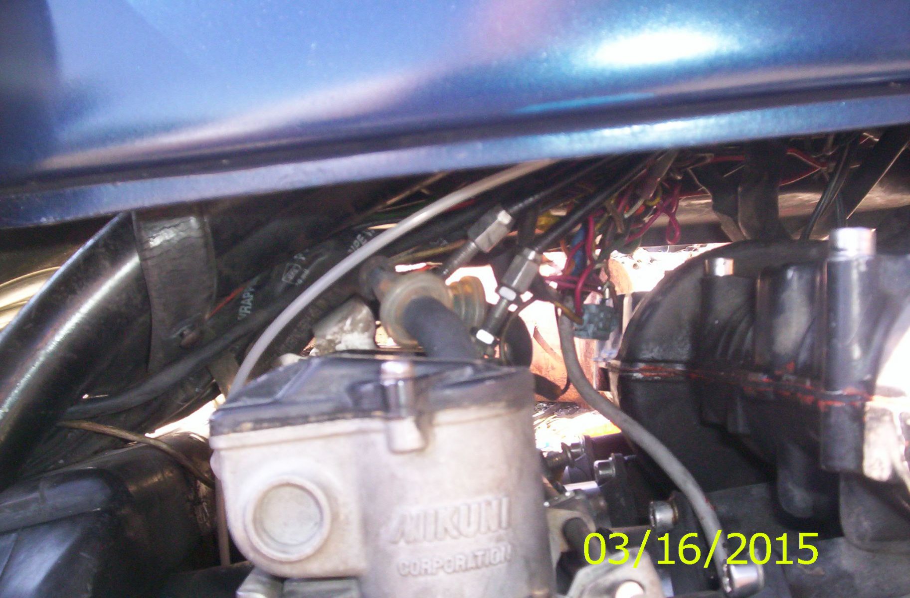

where have you guys found is the best location to put the inline filter, obviously after the petcock and before carbs, but my fuel line is only about 4" long, and is kinda bent in an "S": shape....
not really looking like i could get a filter on it, but i may be mistaken....
its on a 1980 KZ750h, 4 cylinder.
anyone got any pics of where they put the filters????

Get some fuel line and make a loop. Find a place where it is relaxed and put it there.

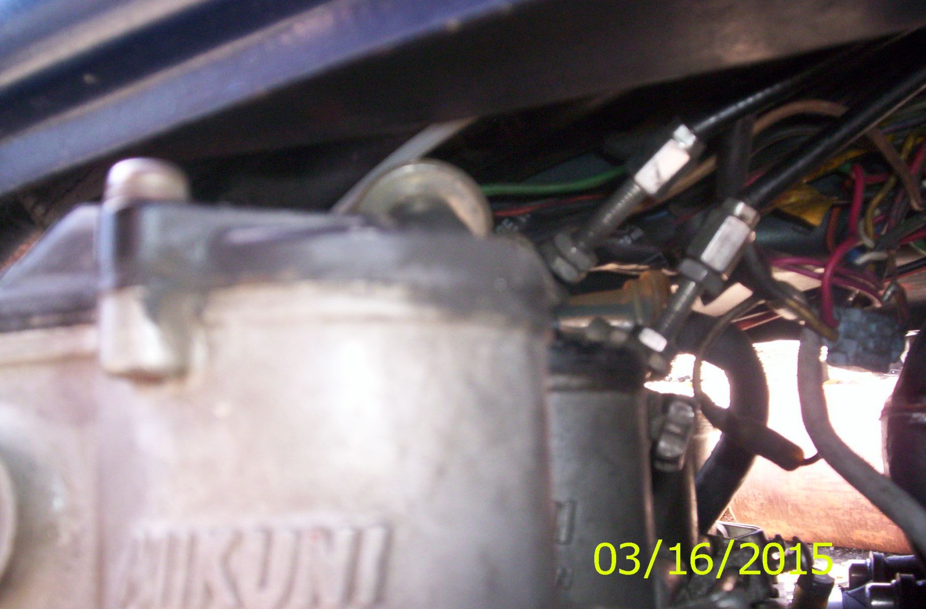

Re: in line fuel filter
16 Mar 2015 16:02
With the 33's I had even less room to put in the filters. The wiring I will tidy up when I pull the tank again.
