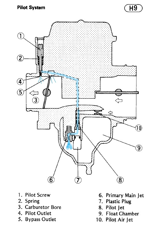

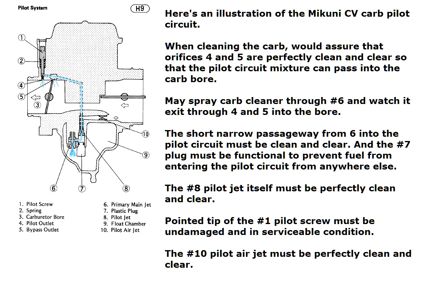

If an imperfect pilot circuit in either or both carbs is causing the problem, it may result from clogged orifices through which the air/fuel mixture enters the carb bore.
The following pics illustrate one means of cleaning the pilot circuit.
