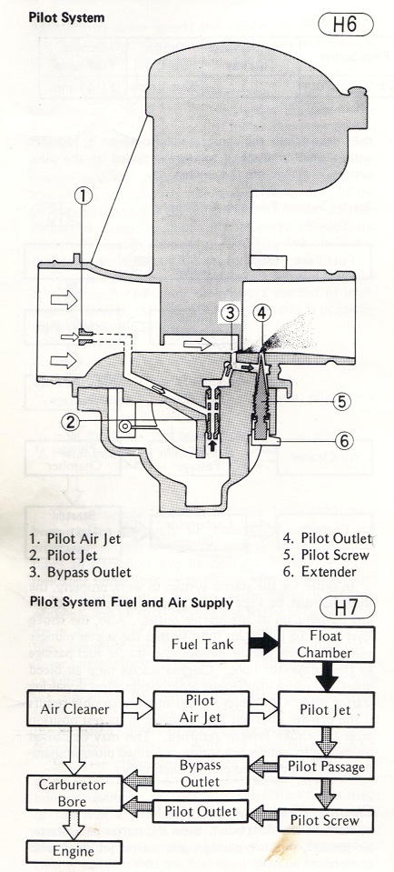

19 Jan 2015 07:24 - 19 Jan 2015 08:03kzdcw wrote: ...F77' KZ1000A... stock VM26 carbs...backed out the Fuel Mixture Screws 1 1/2 Turns...when idling doesn't seem to respond well to quick throttle inputs maybe like it's starving for fuel and returns back to idle slowly?....
Turning the pilot mixture screw out counterclockwise enrichens the pilot circuit.
Conversely, turning the pilot mixture screw in clockwise leans the pilot circuit.

Are your mixture screws before the slides (air cleaner side) or after. If before, the settings are reversed. Post pics if you can.

Steve, My Pilot Mixture Screws are Intake Manifold Side ( Front of the Carb. facing the intake manifolds ).
I thought when you try to open the throttle slightly and slowly and it take a brief moment to respond then returns to idle slowly when letting off the throttle would mean that the idle circuit or Pilot circuit is LEAN ?
If that's the case I'm assuming you would want to Enrichen the Fuel Mixture but thought would be done by turning ( IN ) the Mixture Screw?
I already set the Mixture Screw at 1 1/2 turns out as a starting point.
