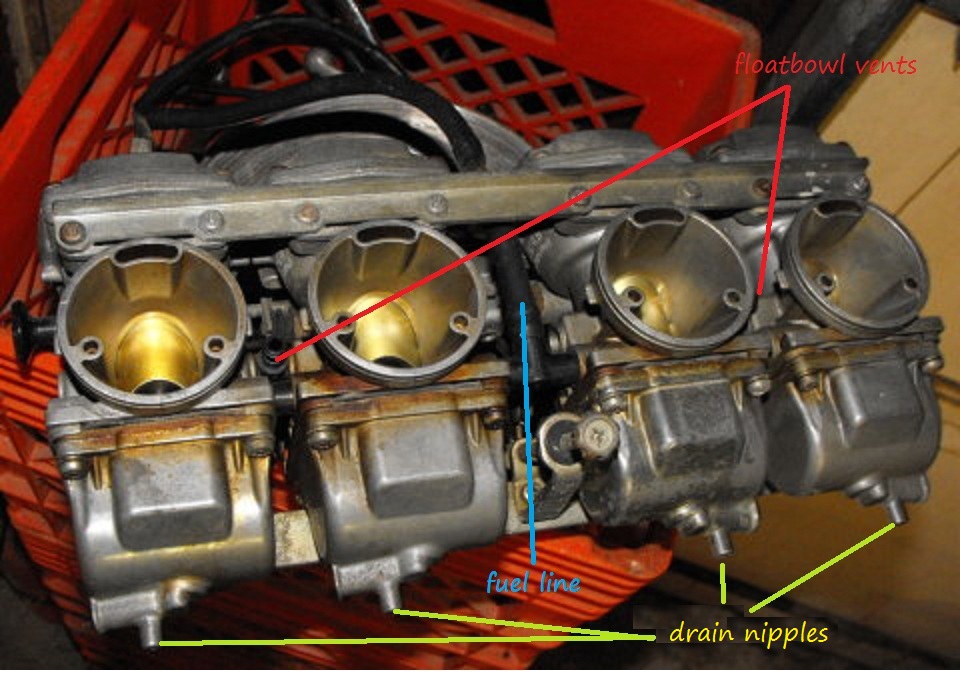

Fuel weeping from under the cap may indicate a blocked fuel tank vent. That can cause it to run fine until a vacuum is created in the tank, starving the engine. After parking it for a bit, heat from the engine can cause pressure to build up in the tank, forcing vapor out under the cap.
Try loosening the cap and taking a gentle ride, you don't wantto slosh fuel all over you crotch! There is no substitute for spotless and properly adjusted carbs, but a clogged vent may be adding to your woes.

Thanks for the reply and the excellent diagrams. That is what is weird about this new problem I am having, beautiful idle with a nearly instantaneous bog when I put the engine under load, and only intermittent at that, almost like an electrical problem. Good advice too on the fuel filter, going to deploy one of those on the next iteration.

I agree with Texas. Check the vent in the cap. If it is seeping that suggests high pressure in the tank thus gas pushing past the float valves flooding the engine. You may have more than one thing going on here. One thing at a time, fix it, move on. Check the plugs. They are a good indicator of what's happening.

22 Jan 2015 09:58TexasKZ wrote: Fuel weeping from under the cap may indicate a blocked fuel tank vent. That can cause it to run fine until a vacuum is created in the tank, starving the engine. After parking it for a bit, heat from the engine can cause pressure to build up in the tank, forcing vapor out under the cap.
I agree with all that, but I am not sure if that is the problem; I took the cap apart yesterday and I am not seeing a problem there, not sure about inside the tank :side:

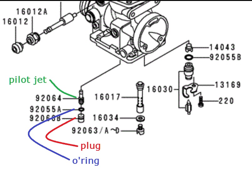

If not already done, would assure that the two carb vent hoses are serviceable and that both of them exit to open air.
The vents are needed to allow supply of incoming fuel into the float bowls.
This illustration may not be identical to carbs at hand --
Also assure the plugs at bottoms of pilot jets are present and in decent condition.
The plugs are needed to assure that gasoline reaches the pilot jet (and pilot jet circuit) only by going through the small passageway from above the main jet.
If the plug (or it's o'ring, if so fitted) is missing or damaged, gasoline from the float bowl may directly enter the pilot jet, which is not good, as the only gasoline that reaches the pilot jet is supposed to be coming through the small passageway.

Well, the good news is I seem to have solved the carb issues. I think that the fourth removal and cleaning must have done the trick, that and spending another half a day and getting the fuel levels very closely dialed in to each other. As a last step I synchronized the carbs. When I was all done, all I can say is *wow* what a difference from where I started! I almost do not need the enrichener to start the bike, I can push it all the way in in less than a minute, and the idle is so smooth, you would think there is only one carb!
Thanks again for the help and suggestions from everyone, I could not have done it by myself. I learned a lot, and I will never fear a multiple carb bank again :laugh:
