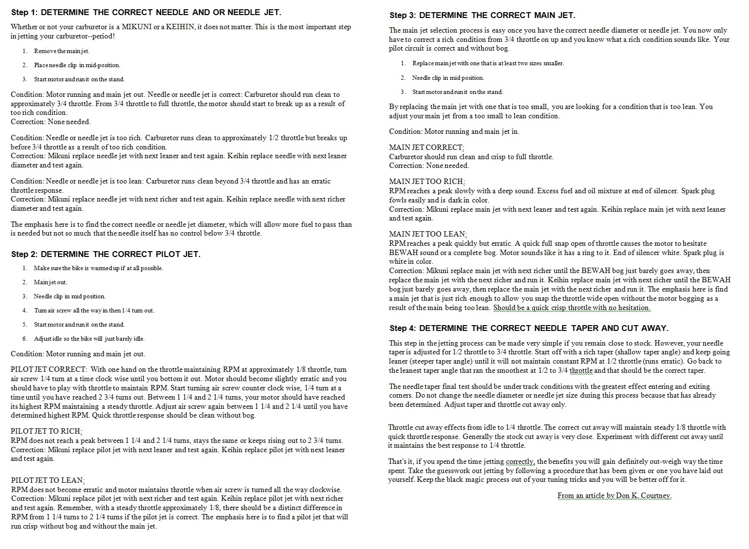

Rule of thumb starting point for pods, 4-1 exhaust, head porting etc...
Also an excellent write u[p on CV carbs rebuilds....
kzrider.com/filebase/search/viewdownload...keihin-cvk40-via-omr
