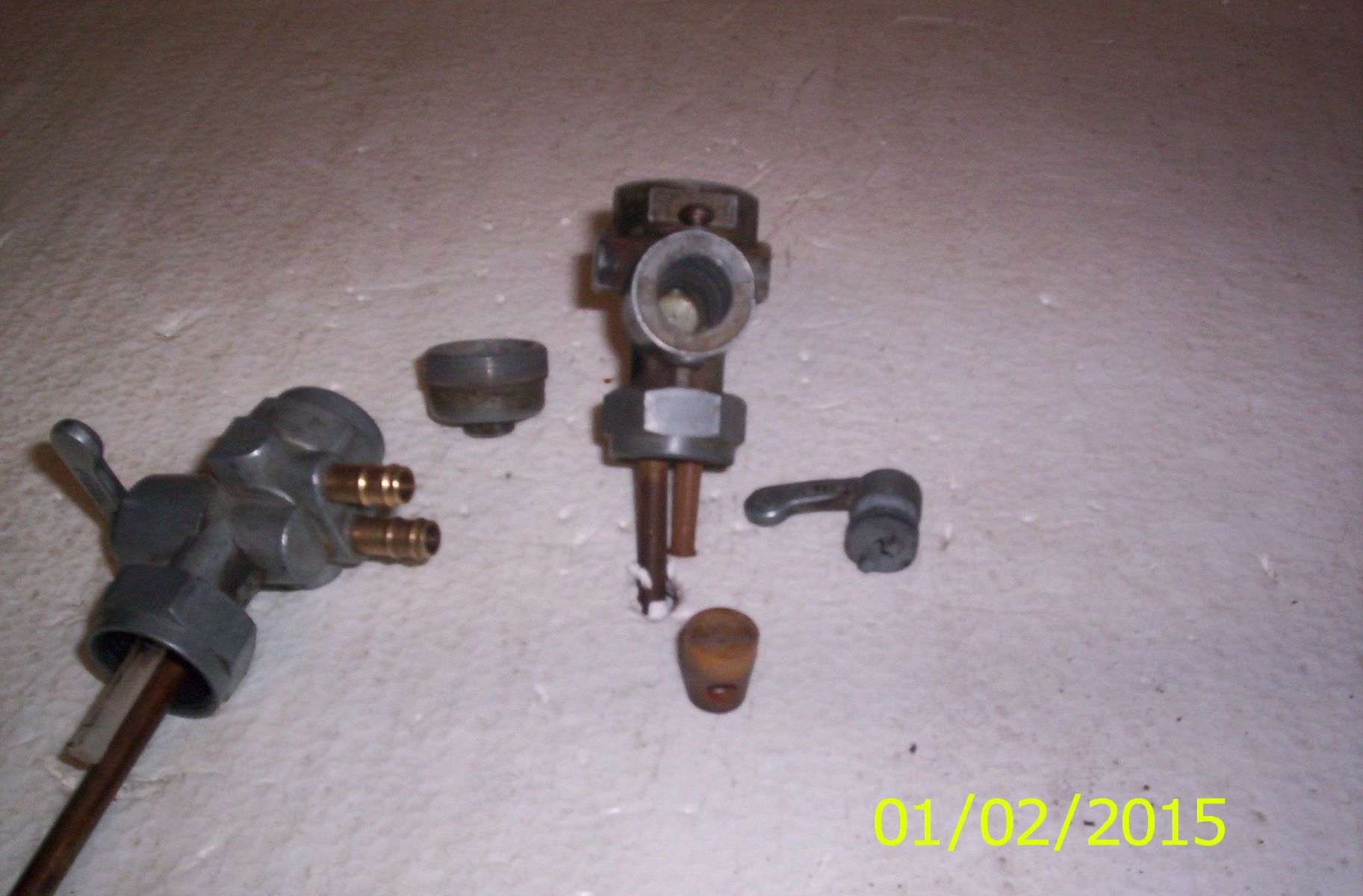

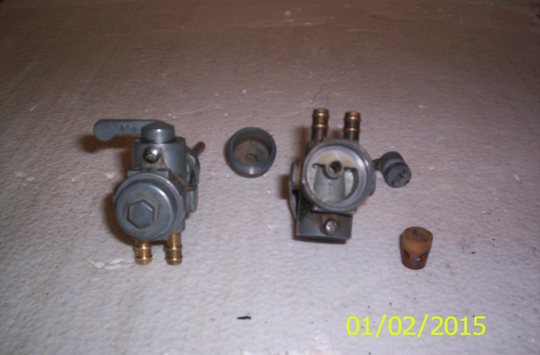

I found my old petcock. The fuel is let through one of two entry points. Both have strainres. The long one is for normal running, the short one is the reserve. The valve has two holes. In the reserve position, it allows fuel to pass through to the sediment bowl. When turned counter clockwise to 9:00, both holes are blocked. When turned to the 6:00 position, it allows fuel to enter the bowl in the run position. The set screw prevents the lever from turning more than 180 Deg. It is possible for the valve to be installed out of sync. The slot on the valve is in the 2:00 position on reserve no matter if it is in the wrong position or not. Turning it 180 should cure this problem. It has nothing to do with which outlet tube goes to the carbs. They both come out of the bowl no matter what.
Here's some pics of the old one and the new one I bought from Z1 parts inc.
