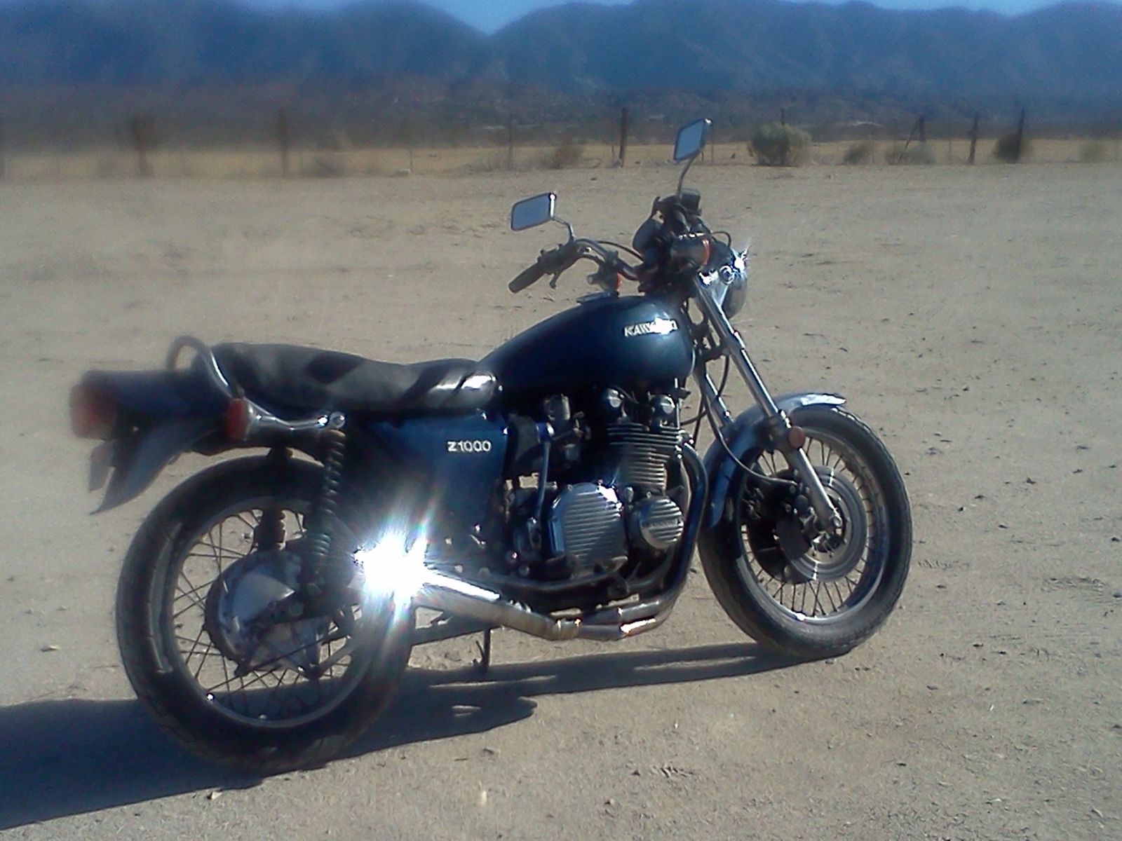

I now have a question about switching BACK to an airbox, FROM pods. My 82 LTD1000 came w pods, and a Kerker 4-1 exhaust. It seems to run mostly fine, maybe a little rich. (I just changed the plug wires and it seems to have woken up a bit..., so maybe I'm not so rich- haven't looked at the plugs yet. Tailpipe gets sooty.)
If I go back to an airbox w/ a lid and all, will I be too rich? p.o. claimed a dynajet kit was put in the carbs and I have no reason to doubt it b/c the bike really seems to be running well. I'm getting about 35mpg,, it pulls strong smoothly and cruises w/o surging at all rpms...
I've already ordered an airbox off of an online auction site, and am about to buy the rubber boots from z-1. I'm worried that I'll need to re jet the carbs back to stockish and not sure what my gains will be. I'd like even better fuel economy if that were possible, and I want the bike to run correctly if it's not already. The rubber boots going to the airbox look like velocity stacks to me, and everything I've read about airboxes vs pods has me convinced, but I wonder if I'm not trying to fix what ain't broke. Thoughts?

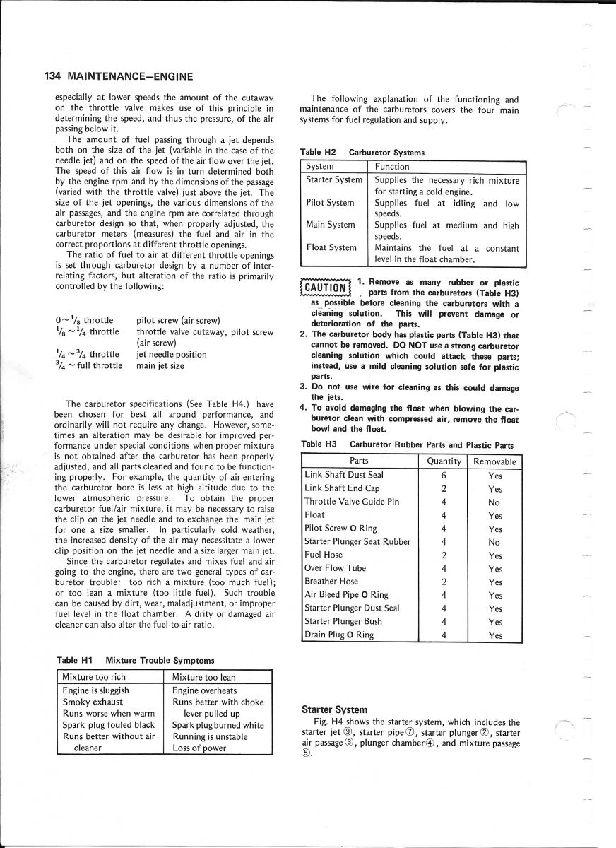

+1 on marking the grips. I make a mark on the bars I can see while riding. I then mark closed, 1/4, 1/2, 3/4 and WOT. This helps me determine what I need to adjust per the Service Manual.
