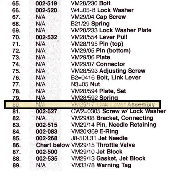

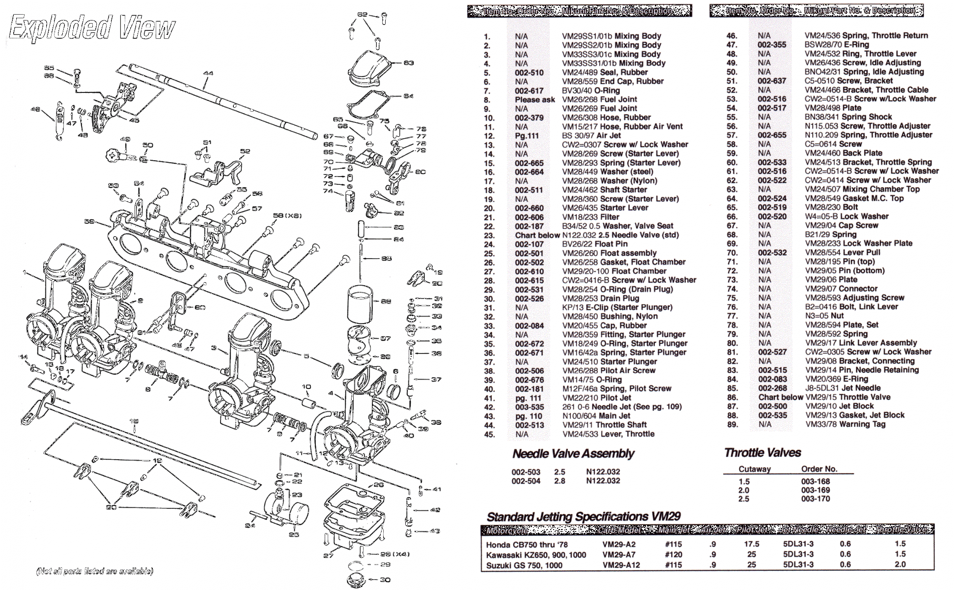

I'm working on my '78 1000A and recently bought a set of "restored" 29mm smoothbores. I installed them and checked the synch and they were out of spec. I began to synchronize them and while I was working on carb #4, I heard a snap from carb #1. The link lever assembly is broken (#80 on the diagram below). I can't find that part anywhere. Does anybody know where I can get that part? It's Mikuni Part number Vm29/17, link lever assembly.

link lever part # 80 is listed as N/A by sudco......maybe find one used link from a set of 29's for parts from someone. ......I feel for ya :dry:

Good news! The guy I bought them from on eBay is going to send the part I need....no charge!
I also heard back from Jim at Redline Cycle and he has a used one for sale. I might get it anyway to have a spare.
If anybody else needs VM29 parts, here are a couple of sites to check. Redline has a lot of parts not listed, so contact them with your needs.
Thanks!
www.redlinecycle.com/Carbs%20-%20Parts%20-%20VM29.html
www.z1enterprises.com/ShopByCategory.asp...bs&category=01043805
www.sudco.com/Diagrams323728/expvm29.gif

Unfortunately, all of those parts where N/A is listed in place of the part numbers are no longer available , even from Sudco.
