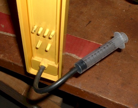

Well, you can actually activate it by sucking on the vacuum line, but don't let anybody see you. :whistle:
The less embarrassing option is to go to any pharmacy and get a large, plastic syringe. Put that into the vacuum line and that should activate the fuel flow easily.
This is the one I use on manometers, but it also works for petcocks.
Are you using a car fuel filter? The see through ones with paper elements often will stop flowing. They are meant for fuel pumps. Gravity doesn't apply enough pressure.
I've posted this before, but I'll post it again in case others might not have seen it.

23 May 2014 06:42loudhvx wrote: Well, you can actually activate it by sucking on the vacuum line, but don't let anybody see you. :whistle:
I have been using a fuel filter, but thought it could be a culprit so it's currently not attached. After taking it off, fuel flowed slightly, but not nearly enough. Is there a filter that I can use?
I've taken apart and cleaned the petcock and there wasn't much gunk in there. Nothing changed when I reinstalled it.

So I tried sucking on the vacuum line attached to the petcock, and a little bit of fuel flowed, but stopped after a second. Is there maybe a diaphragm that's getting stuck when vacuum is applied?
I also tried this with the tap set to PRI and had the same results; just a little shot of fuel then nothing.

Sounds like the petcock needs rebuilding. Passages clogging and vacuum diaphram leaking perhaps. Clean and seal the tank too so it doesn't clog up the petcock again as well as make rust holes .

Yup, should have flowed continuously under both conditions. The normal position takes gas from one pipe, and the prime position takes gas from the reserve pipe. So if there's any gas, it should have flowed.
So the petcock will have to be inspected.
Clean the tank, but only use a tank liner if you absolutely, absolutely have to. It's mess if the liner goes bad.
