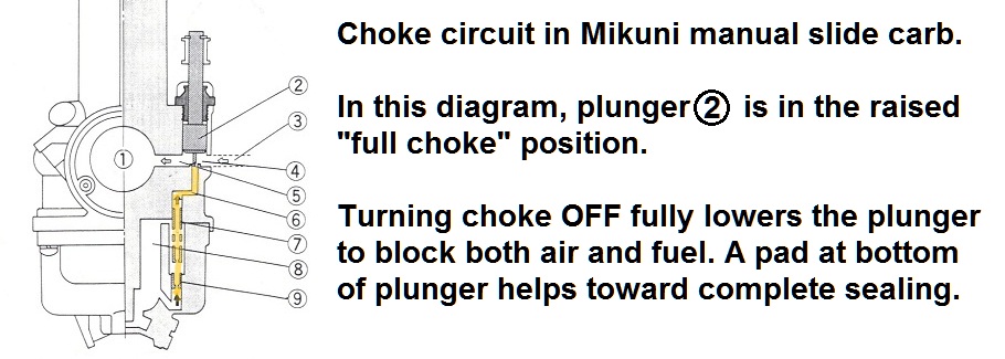

Would also check tightness of the clamps holding carbs to their holders.
And assure all vacuum caps/plugs are present, fitting properly and in good condition.
Could also test for air leak in the vacuum hose to petcock -- remove the hose from its vacuum nipple, plug/cap the nipple, switch petcock to PRIme position and test run. This should discover or rule out a vacuum hose leak or possible air leak from an internally defective petcock.
Air may also leak through worn or defective pads on the choke plungers.
Question -- is the clean-air system still fitted? (It has various air-leak-prone hoses and components.)
Could also resort to spray testing with WD40, because it produces smoke from the exhaust when ingested through an air leak source.

14 May 2014 12:12ShouterVW wrote: I no longer have the vacuum Petcock. And the corresponding vacuum nipple on the carb is plugged. I also got rid of the clean air crap, branched the ports on the valve covers, and capped the 2 nipples on the carb boots. I never thought of the choke plungers. Will spraying them do any good?
Would double-check the other possible air leak sources before investigating condition of the plunger pads. Worn or damaged pads are more likely to admit fuel rather than air when the plungers are fully down (choke OFF). In the case at hand, would just assure that all four choke plungers are closing fully down when the choke is off.
