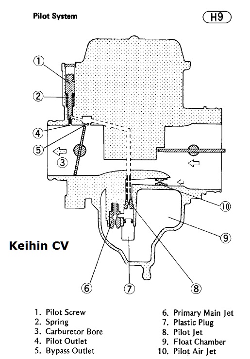

The pilot system in the CV34s has a number of internal passages some of which are very narrow and blockages can be hard to find and can cause pilot problems. Soaking with carb cleaner is never enough and thorough cleaning usually requires a nylon bristle or a 1st guitar string or I have even used 50lb strain nylon fishing line and all followed by blowing everything with compressed air.

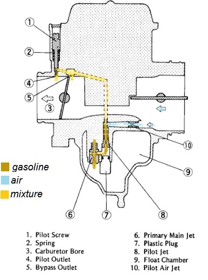

When I bought my bike bike back in 03 I lost count of the number of times I cleaned the carbs trying to fix a low speed (pilot) issue and then I discovered the "Bypass outlet" holes. See attached picture
These 3 holes in a triangular arrangement are on the engine side of the carbs and you need to have the throttle butterflies wide ope before you can see them. They are tiny and crud can block them. I used a long pin with the tip bent at right angles to clean them out. Another are to investigate would be the pilot screws and the pilot outlet.
Hope this helps
Hope this helps

Thats EXACTLY what I was experiencing (bad stumbles under 3000 rpm) when I got the bike first with 4->1 and individual pods. I cleaned and cleaned and gave up and wasted $300 at a bike shop who blamed the pods and finally with the riding season almost over I did a really thorough and painstaking carb cleaning and found those holes and poked them clean.
If everything is clean then these carbs work well and are very forgiving when it comes to modifications.
Patton has just posted a great diagram above. Squirt in carb ckeaner where he has highlighted and make sure to wear safety glases. That stuff will come right out where least expected and is extremely painful when it hits an eyeball
Good luck

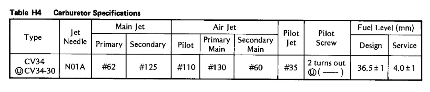

Regarding the exhaust I found that upping the secondary main jet from stock 125 to 130 worked well with the 4 ->1
Your bike being an 83 shaftie may have different stock jetting but the above should give you some ideas of what you might need. These jets are available from Z1 Enterprises for about $2 each

Upping Primary main jet from stock 62 to 65 also works wonders!
130 - 65 - 35 is Wired George recommended setup for 4-1 and K&N inside air box.

I dont have a secondary or primary main jet. just main jet and pilot jet. pilot is a 35 and the main is a 100. needle is n10c. I will check those passages to be sure though and let yall know what if any change.
